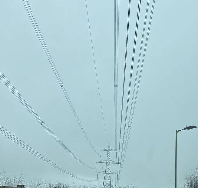

Hi, saw another pylon arrangement the other day that got me thinking back to this post. This is a head on picture to pylon:

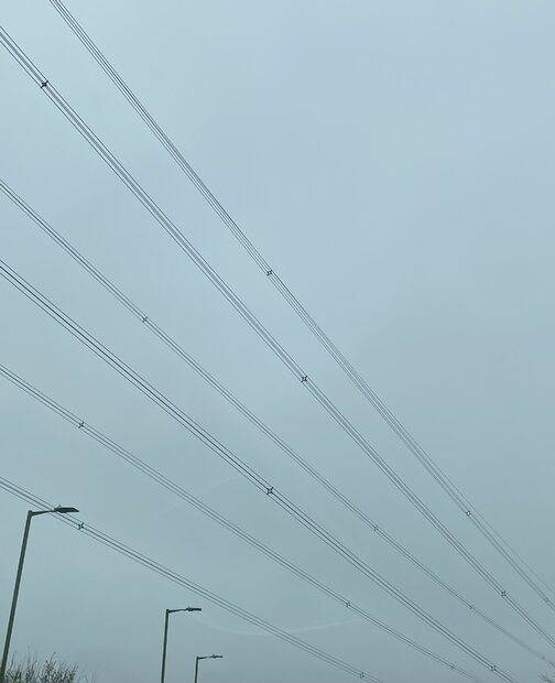

And this is to the side:
In the OP you said a pair of wires forms a single phase and are sent down as a pair to reduce corona discharge. What is happening here with each set going down as 3 wires with spacers? Would these be two sets of the same phase? Thanks
Each conductor is a bundle of 4 wires, all electrically connected together at every spacer and at the bottom of the insulator. Four wires makes the bundle appear to have a greater radius. A line will probably need 4 wires to reduce corona discharge if it is operating at or above 500 kV.
There are three of those conductor bundles for each 3 PH circuit. There are two circuits shown, one on each side of the pylon. Given that the pylon in the OP wiki example was located to the north of minor road, east of Efail Isaf, Llantwit Fardre, South Wales. UK.

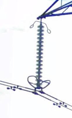

You can see the spacers between the pair, or bundle of wires;
https://en.wikipedia.org/wiki/Overhead_power_line#Bundle_conductors
The loops to prevent corona at the bottom of the insulator;
https://en.wikipedia.org/wiki/Corona_ring
and the vibration dampers;
https://en.wikipedia.org/wiki/Stockbridge_damper

Great thanks for such a detailed response. Just so I have understood correctly; So all four of those bundled wire sets form a single conductor of one phase? The three sets of four on one side form a complete 3 phase unit? I did some reading on corona discharge and it mentions increasing wire diameter reduces this effect so the 4 wire bundle effectively increases the wire diameter? Is the 4 wire bundle purely for his effect then - so if corona discharge wasn’t an issue they would all be single wires?
Correct.
Correct.
That is right. For higher voltages use 6 or 8 wires in the bundle.
The 4 wire bundle, with the wide spacer, is there only to reduce corona discharge.
Since 4 wires are used they can be thinner and still carry the same current as one thick wire.

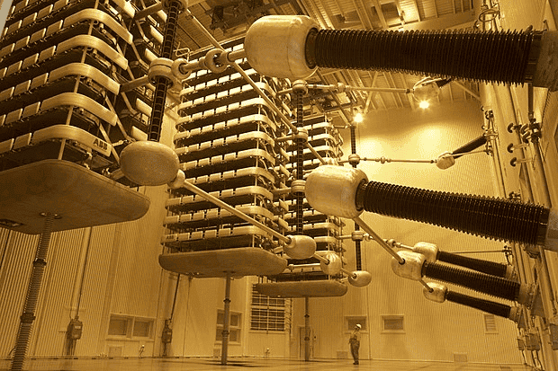

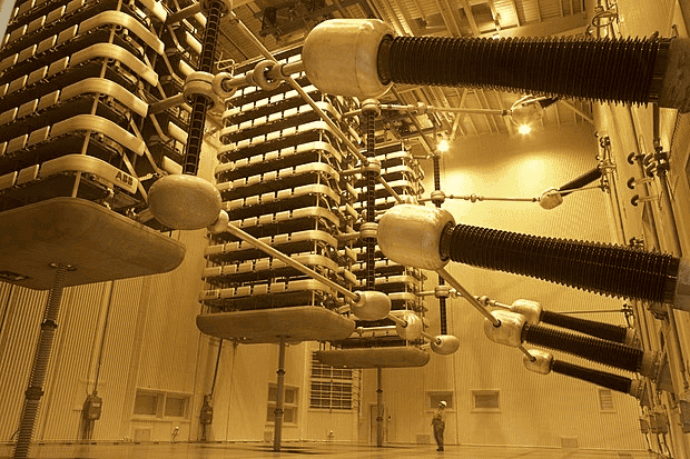

berkeman said:
Why do they use DC for those transmission lines?
There's something wrong in that article. It talks about China's HVDC, but the picture with the article is of an AC line, not DC.
DC allows connecting areas non-synchronized, or with different frequencies. The power flow in the DC line can be controlled by computers instantaneously, thus offering control and stability advantages to the grid.
DC lines also do not generate reactive power (VARs). With AC lines the higher the voltage the more VARs. Therefore, DC is able to push to higher voltages than AC.
The disadvantage is the rectifiers/inverters to interface to AC at the terminations and every intermediate tap point of the DC line. That stuff (below) is not cheap. For scale, see the man on the floor. The picture is of the HVDC tie between the North and South islands of New Zealand.
I didn't even read the article. I was only interested in showing an example of the larger lines. I guess I should have found a "correct" article to link to.
Dang pop-science sources! :wink:
Oh man, I want a tour of that facility lead by the chief EE and the systems designer. Maybe when the power is off, LOL.
Also, less transmission loss with HVDC because of no radiated power and lower current with really high voltage. I think this is the same as the comment above about VAR. This applies mostly to long transmission lines. The other type are short links between incompatible systems as mentioned.

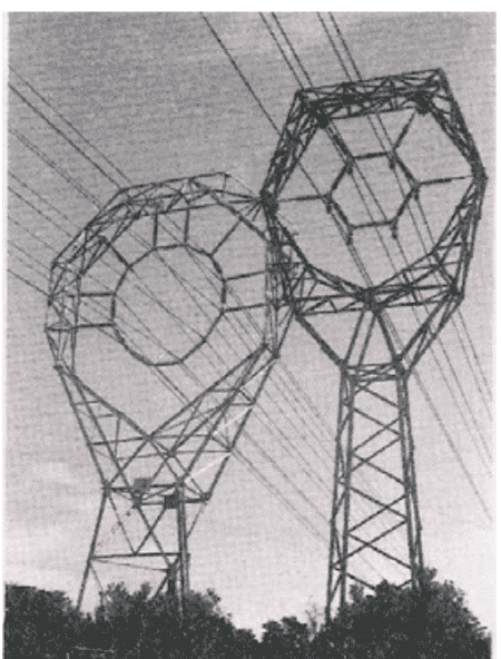

anorlunda said:
Those ideas were explored in the 70s, but discarded because the improved electrical performance was not enough to offset the increased costs.
OMG I am sure I remember seeing pylons like those near Didcot power station in Oxfordshire in the late 60s/early 70s. I had forgotton about them until now.

anorlunda said:
Yes. In fact, if the material in that bundle could be arranged to make a hollow cylinder, that would be good electrically.
In those examples the parallel wires are carrying different phases of the balanced circuit, so it does not actually reduce corona discharge. It reduces the external E and M field losses from the transmission line.
A bundle of electrically connected wires make a single conductor with a greater virtual diameter, which reduces the corona discharge. The bundle has greater capacitance to other bundles, but with a lower self inductance than a single wire. Then since; Zo = √(L/C), it lowers the characteristic impedance of the transmission line.
When used for radio antennas, the bundle technique is called a “cage dipole”. A dipole was often slung between two masts of a ship, where the ends were tapered to reduce capacitance at the masts. The advantage of a cage at RF is that the diameter can be tapered along the dipole, which sharpens the tuning by reducing losses due to impedance changes along the line.
