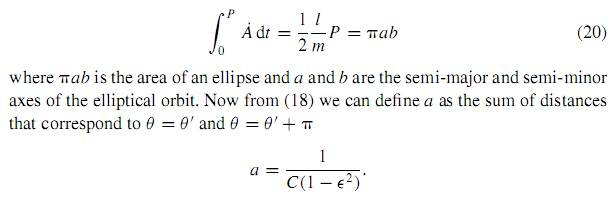

I hope this the right place to post my question...
should it be, "we can define a as half the sum of distances..."?
please correct and explain if I'm mistaken
thanks

You are mistaken.
When [itex]\theta= \theta'[/itex], [itex]1/r= C(1- \epsilon cos(\theta- \theta')=[/itex][itex]C(1- \epsilon cos(0))=[/itex][itex]C(1- \epsilon)[/itex] so that [itex]r= 1/(C(1-\epsilon)[/itex].
When [itex]\theta= \theta'+ \pi[/itex], [itex]1/r= C(1+\epsilon cos(\theta- \theta- \pi)=[/itex][itex]C(1- \epsilon cos(\pi))=[/itex][itex]C(1+ \epsilon)[/itex] so that [itex]r= 1/(C(1+\epsilon)[/itex].
The total distance between those points is [itex]1/C(1+\epsilon)+[/itex][itex]1/C(1- \epsilon)[/itex][itex]= (1/C)(1/(1+\epsilon)+ 1/(1- \epsilon))[/itex]. Getting the common denominator, [itex](1+\epsilon)(1-\epsilon)= 1-\epsilon^2[/itex], we have
[tex](1/C)\frac{1- \epsilon+ 1+ \epsilon}{1- \epsilon^2}= (1/C)\frac{2}{1- \epsilon^2}[/tex]
Half of that is
[tex]a= \frac{1}{C(1- \epsilon^2)}[/tex]

and that's what I've said :confused:
thank you
