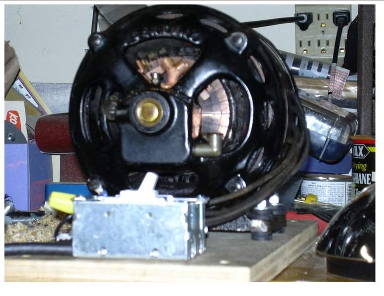

Here is a picture of a single-phase induction motor with no "starting" coil. It is a repulsion-start motor, made in 1914, with a radial commutator used for shorting some special squirrel cage copper busses inside the rotor. It has a higher starting torque and lower surge current than modern split phase or capacitor start motors.
Why has this motor become obsolete if it is a better design?
And how does this motor work? Can a circuit diagram be posted in this thread?

Why has this [repulsion start electric] motor become obsolete if it is a better design?
It is about twice as heavy as a modern motor with same HP, and very expensive to build.
Look up "Repulsion start electric motor" on web. There are articles discussing theory, and at least three videos showing Century Electric repulsion start electric motors in operation.

The best thing you can do is get an old washing machine split phase 1740 RPM (60 Hz) or 1450 RPM (50 Hz) induction motor and take it apart. Note first the squirrel cage on the rotor and the four main coils on the stator. Note also the four smaller starting coils on the stator midway between the main coils. The starting coils have smaller diameter wire and a higher dc resistance than the main coils, so they have a lower L/R time constant. This means that when a voltage is applied to the coils, the current in the starter coils has a phase shift relative to the main coils. This phase shift, plus the location of the starter coils on the stator, produces an apparent rotating dipole field in the rotor. Reversing the connections to the starting coil reverses the rotation of the motor.
