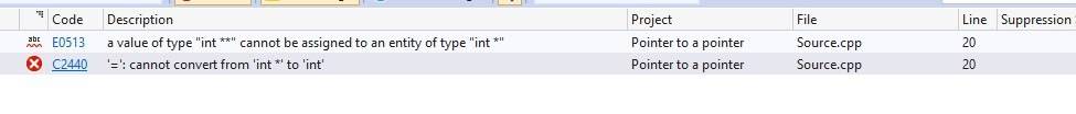

I have a question on initialize pointer. The books said it's illegal to do this:
C++:
float myFloat;
int *pint = &myFloat;
I understand myFloat is a float, not an int. But the starting address of the variable myFloat is an int. Why can't you initialize int *pint to the address of myFloat?

What do you think is the type of &myFloat?
Integer!, it's the address of the first byte of the variable myFloat.
It points to the first byte of the variable, who cares whether it's a float or int or anything.
There's your problem. You don't know what the type is.
Is int *pint declare the ADDRESS?
Is &myfloat giving you the address of the first byte of the variable of myfloat?
It's the address, who cares about whether the content of myfloat is a float or int. It's the address.
No. It's a variable that can be used to store an address to an int. Its type is (int*).
It's giving you a value of a particular type (int*), that holds the first byte of the variable myfloat.
In C and C++ you have formal types with precise definitions, and the compiler does type checking to make sure the types you are using match up.
See Mark's post to see why it's not the same thing, and doesn't give the same results whether it's a float or int.
I am ok if you said you are NOT allow to do this, I can obey that. BUT if the book said int *pint declares an address, and the address of a float is an integer, there is a problem. That's why I post the question here.
BTW, do NOT ever take what the books said is the truth. I challenged the most famous book on Phase Lock Loop and the author offered me to send me the manuscript of the latest version. They are only human.
I just read the Gaddis book and put it in the notes with page number. You can check if I am right, this is my understanding. It is on the notes of Chapter 9 page 496.
yungman said:
I am ok if you said you are NOT allow to do this, I can observe that. BUT if the book said int *pint declares an address, and the address of a float is an integer, there is a problem.
There is no type that is called (address), or (integer) in the C++ type system. The book is not wrong. You just don't understand what a type is. What you are reading in the book is an english description of what it is, not what it's type is.
Jarvis323 said:
There is no type that is called (address). And integer isn't a type in the C++ type system. The book is not wrong. You just don't understand what a type is.
Yes, it said int *pint define as address of pointer pint. int *pint initiates a pointer of address.
