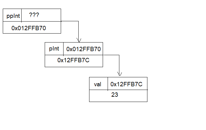

yungman said:
What is the ** mean?
As I said before, it's a pointer to a pointer. In other words, it's a pointer that stores the address of a variable that stores a pointer. In this case the variable that stores the pointer is pNumber, and you are passing the address of that variable to the getRNum function so the function can assign a value to it, namely the address of the array you allocate with new.

  • #137
yungman said:
it still did not return the pointer back to main.
That's because the type of the parameter pArr in the function signature for getRNum is still wrong; it needs to be int**, not int*. Then you pass the address of pNumber to the function using that parameter.
  • #138
To expand on this a bit, consider:
What your code is doing now:
(1) Initializing a variable whose type is "pointer to a variable of type int" to be a null pointer.

Hi Everyone
I have been doing a lot of googling, trying to learn pointer to a pointer and how to solve my problem I think I found it. But I just need to read more and let it sink in first before I post back. I don't want to jump the gun again. Here is the very simple program that works already, I just need to digest first, I still have a little difficulty bending my brain to say I got it.
C++:
// Pointer to a pointer
#include <iostream>
using namespace std;
void changePtVal(int**);
int Gvar = 42;
int main()
    int var = 23;
    int* ptr = &var;
    count << " Before calling changePtVal, *ptr = var = " << *ptr << " ptr = " << ptr << "\n\n";// the content in address ptr = var =23.
    changePtVal(&ptr);//**pptr = &ptr.
    count << " After calling changePtVal, *ptr = " << *ptr << "\n\n";
    count << " address of var = " << &var << " ptr = " << ptr << " *ptr = " << *ptr << "\n\n";
    return 0;
void changePtVal(int** pptr)
    *pptr = &Gvar;
//The result is:
//Before calling changePtVal, * ptr = var = 23 ptr = 012FFE48
//After calling changePtVal, *ptr = 42
//address of var = 012FFE48 ptr = 00EEC008 * ptr = 42
In case, this is the site I am reading:https://www.geeksforgeeks.org/passing-reference-to-a-pointer-in-c/

I think I got it, I need to practice more though. This is the program using pointer to pointer:
C++:
#include <iostream>
void getRNum(int**, int);//return a pointer from the functionint main()
    int size = 5;
    int*pNumber = NULL;//initiate a pointer number
    getRNum(&pNumber, size);//pass address of pNumber
    count << " Back to main, pNumber = " << pNumber << "\n\n";
    count << " The array pointed by pNumber = {";
    for (int count = 0; count < size-1; count++)// display the numbers
        count << *(pNumber + count) << " ";
    count << *(pNumber + size-1) << "}\n\n";
    delete[] pNumber;//free the memory of 5 element array number[5]
    return 0;
void getRNum(int** pArr, int num)//receive &pNumber the addresses of pNumber.
    int* Arr = NULL; // set pointer Arr to Null
    Arr = new int[num]; //request 5 elements of int of memory from computer pointed by Arr.
    *pArr = Arr;// *pArr = address of Arr[0].
    for (int count = 0; count < num; count++)// input 5 integers to Arr[0..4].
        count << " Enter number " << count + 1 << " = ";
        cin >> *(*pArr + count);//*pArr = address of Arr[0], pArr + elements = address of Arr[1...]
        count << " In memory location of Arr: " << (Arr + count) << "\n\n";
Enter number 1 = 2
Enter number 1 = 2
 In memory location of Arr: 012B4D50
 Enter number 2 = 3
 In memory location of Arr: 012B4D54
 Enter number 3 = 4
 In memory location of Arr: 012B4D58
 Enter number 4 = 5
 In memory location of Arr: 012B4D5C
 Enter number 5 = 6
 In memory location of Arr: 012B4D60
 Back to main, pNumber = 012B4D50
 The array pointed by pNumber = {2 3 4 5 6}
I copy the display from running the program. It ask for 5 integer, I put in 2, 3, 4, 5, 6. You can see the physical address for each element. I print out the address of Arr( same as Arr[0]), they when the function exit back to main, I printed out the content of pNumber. You can see both address match. So the pointer is PASSED back to main from the function.
Thanks

Why this work:
C++:
#include <iostream>
int main()
    int var = 23;
    int* ptr= &var;
    int* pptr = ptr;
    count << " var = " << var << "  *ptr = " << *ptr << "  **pptr = " << *pptr << "\n\n";
    return 0;
BUT, this doesn't work?
C++:
#include <iostream>
int main()
    int var = 23;
    int* ptr =&var;
    int* pptr;
    *pptr = ptr;// Error
    return 0;
that is int* pptr = ptr; in the first one works, but int* pptr; *pptr = ptr; in the second one doesn't.
