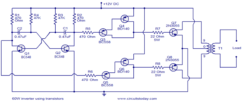

Let me add some clarity. We need thousands of volts for a certain aerospace application that is battery powered. This would normally be done by transformers, to ramp up the battery voltage but transformers have heavy ferrite cores whose weight is precluded in this application. (It needs to be highly weight optimized.)
According to Jim Hardy we can reduce the size of the core by using high frequency AC. Ideally the transformer would even be air-cored with no ferrite core at all.

You don't have to invent it yourself. DC to AC conversion is called an "inverter." Plenty of them are available commecially.
Small ones, like this cigarette lighter inverter could be scavenged for just the parts needed in a light weight drone. The schematic is below.
But why have AC at all? Sticking with DC requires zero size or weight for an inverter.
