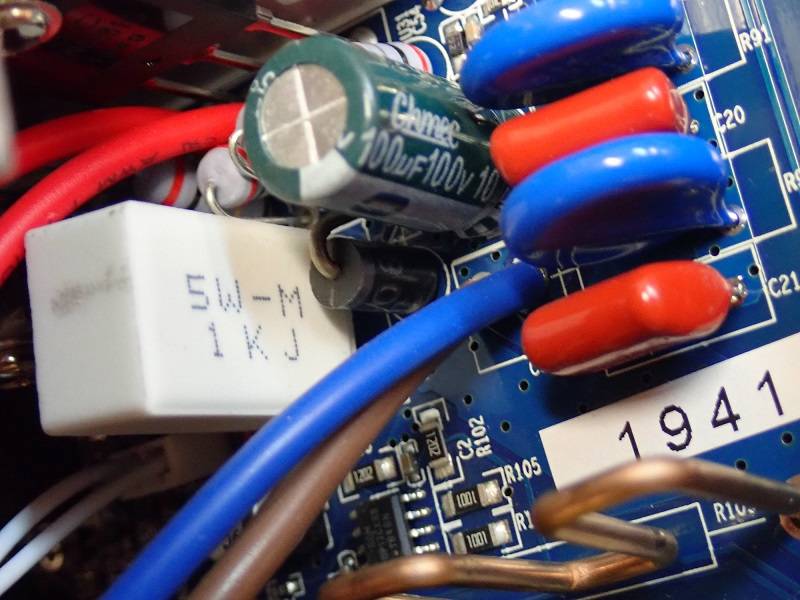

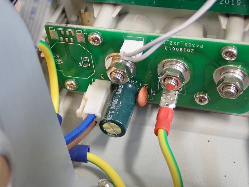

The only sparks were between the leads and the battery. No visible or odor of magic smoke. Photo of output board. The three bolts with nuts are the outputs, the brown and black wire pair is apparently the power to the outputs.
Close-up photo of a green circuit board inside a power supply, with a dark green electrolytic capacitor, a small orange component, bolted terminals, and blue, brown and yellow-green wires.
And a photo of the other end of that blue and brown wire pair:

Immediately to the left of the wire pair connection to the board is what looks like a diode. It has a gray stripe at the upper end, and a label on the board (not visible in photo) D19.

I took some ohmmeter readings. There are three output terminals.
The black one is labeled -
The green one labeled GND
The red on labeled +
Resistance from black to GND = OL in both directions (overload, infinite ohms)
Resistance from red to GND = OL in both directions
Resistance from black to red = 0.3 ohms in both directions
Resistance from both black and red to accessible end of diode = 0.3 ohms in both directions.
Both directions means that I switched the DMM probes.
It looks like I should remove that circuit board and visually confirm that the diode is connected across the blue and brown wires. If so, it's fried. So what should the specifications of a replacement diode be if I cannot find a part number?
Not necessarily. Since it's connected to an unknown circuit, you don't really know what you are measuring. Without a schematic, you really need to disconnect it to know for sure. OTOH, yes, it's likely. So, if you'll probably have to replace it anyway, cutting a lead isn't that expensive. If you do that try to cut it so that you can solder it back together if we are wrong.
It has a label on the package, I can see part of it. But, yes, we can pick a common replacement. That's not a very sensitive application.
Also, 0.3 ohms is small enough that you have to be careful about the measurement, like the lead resistance and such.
3 ohms across the output is a very good first clue. It should not be there. Disconnect things until you narrow down what is shorted.
OK, if we continue the speculation that it's a shorted diode that needs replacing, then here's what I would choose:
1) The biggest diode that fits on the PCB without difficulty. It looks like maybe a DO-201 or DO-27 package to me. Those have a body of ~5mm dia. x ~9mm. Lead diameter is also important so it fits in the PCB easily. The point here is that you want it to tolerate as much abuse (power/energy) as it can while it tries to protect the circuitry upstream. Size matters for energy absorption.
2) Absolutely must have a reverse voltage rating above the maximum PS output. I wouldn't use anything below about 40V for a 30V PS, but I'd be more comfortable with 60V. Higher that that is fine but of little cost or benefit.
3) The highest forward current rating you can easily get. This probably means a Schottky diode. Something like:
SB2060 - 60V, 20A, DO-201
SB10150 - 150V, 10A, DO-201
STR10100 - 100V, 10A, DO-201
4) Speed doesn't really matter.
The selection tables at sites like Digikey or Mouser are your friend in this regard.
If it is just a reverse diode, you can disconnect it and test the PS without it to see if that is the only problem. It has no function in normal operation.
It also could be a transient suppression zener, something like 1N4755A, but I strongly doubt it. They won't work as well at reverse polarity protection, by a lot, and transient voltage protection would be better located upstream of filter elements (L's and C's at the output) with a smaller device.

The 0.3 ohm I listed above is the lead resistance. I got the diode out. It measures near zero ohms in both directions. It's a 1N5408. Digikey lists it as obsolete, and a 1N5408G as a drop in replacement. Cost is $0.47 each, with minimum order of one.

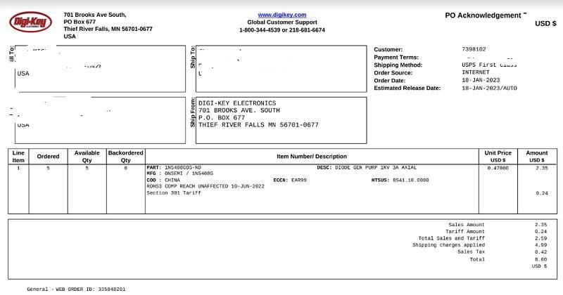

Digikey's minimum order is $25, no? Or have they gone the Amazon route? :smile:
A little hard to read, but $8.00 with tax and shipping for 5 diodes.
Digi-Key PO Acknowledgement receipt for 5 units of part 1N5408GOS-ND, diode gen purp 1kV 3A axial, unit price 0.47000 USD, total 8.00 USD including tariff, shipping and tax.
I heard by the grapevine digikey no longer has the $25 minimum. I haven't ordered from them for a while. There's one way to find out.
Yeah, based on JR's invoice, that is no longer a requirement. Good to know! :smile:
