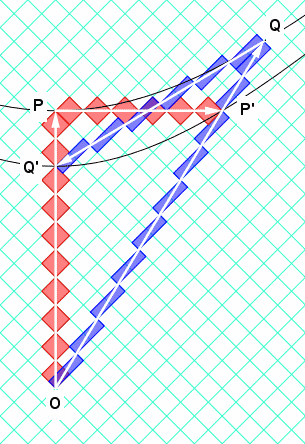

One way to see this visually is to draw a spacetime diagram. I recommend ##\gamma=5/4## instead of 2. Draw light pulses from each “dump” event, one that is emitted and one that was received at the dumping. Each frame will claim that the other frame’s dump is simultaneous with the event on their own worldline which is halfway between the emitted and received light pulses.

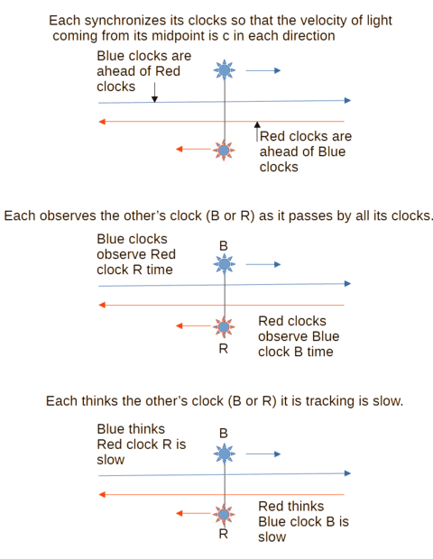

Maybe this will help to clear up the difficulty of the symmetry.
I'm not sure how to do that, but I'll try if I get good enough at the language of SR.

FactChecker said:
Maybe this will help to clear up the difficulty of the symmetry. View attachment 336519
Thanks for diagram, I didn't understand it the first time I looked at it, maybe in time I will understand.
In my attempt to understand this is the red arrow showing the movement of R relative to a rest frame B?.
Does the blue arrow show the movement of B relative to a rest frame R?
The first slide puzzles me a little, it says "Blue clocks is ahead of red clocks" does this mean blue's clock is ticking faster than the moving red clock?
Thanks for making the diagram.
Yes, but it is just relative to B without indicating which frame is a "rest" frame. Both frames have equal rights to call themselves a rest frame.
Yes.
No, that is a step too far. You should not be immediately thinking about ticking speed, but just think about how the clocks are set to be synchronized so that the speed of light is always c. Experiments show that is true. We are initially considering how clocks are set up and down the line rather than their ticking speed. The only clocks that we will consider the ticking speed of are the ones labeled B and R that are initially at the center. We will consider their speed by comparing them to the string of opposite-colored clocks along their path. But that will come in the later steps.
Looking at the left side from Red's point of view. Red can assume that he is stationary and everything is normal. Suppose Red has measured one light-second to the left of his center. He sees that Blue on the left side is rushing toward the center and will hit a light pulse (from the center) too early. Yet Blue still measures the speed of a left-directed pulse of light as c. How can that be? Blue clocks on that side must be set so that one second of Blue time elapses too early. Blue clocks are set ahead of his Red clocks. The farther to the left you go, the more they are set ahead.
Looking at the right side from Blue's point of view says that Blue will think, similarly, that the Red clocks are set ahead of his.
Yes.
I just read this and didn't really grock the last two paragraphs, I'll read it again later, hopefully I can understand.
In your example are you using light clocks where the pulses travel vertically on the graph?
Usually it doesn't matter how the light clock is oriented I'm pretty sure so I'm not sure if my question gets to the meat and potatoes.
No. The light pulse is horizontal and is just to verify that the Red and Blue clocks are initially synchronized (versus their respective central clocks, R and B) so that the speed of light is c in their respective inertial reference frame.

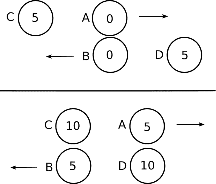

As explained by others before, one can understand the symmetry of time dilation only in connection with relativity of simultaneity.
So let's say we have two clocks A and B at the same position, both indicating 0 at the start.
In the rest frame S1 of A we have another clock C synchronous with A.
In the rest frame S2 of B we have another clock D synchronous with B.
In order to simplify matters, we chose another frame S3 in which S1 (together with A and C) is moving with +v, while S2 (together with B and D) is moving with -v. This has the advantage that all four clocks have the same time dilation as seen in S3, and we furthermore choose v so that the Lorentz factor becomes 2 in S3.
We also observe that when A and C are synchronous in S1, they are not synchronous in S3 due to relativity of simultaneity, but C is ahead of A by 5 seconds. Likewise, when B and D are synchronous in S2 they are not synchronous in S3 due to relativity of simultaneity, but D is ahead of B by 5 seconds. This is described in the first part of the following image.
In the second part of the image we see the result when S1 and S2 continue their motion for 10 seconds (S3 time) until the clocks coincide. Since the time dilation factor is 2 and all clocks have same speed, all of the clocks will advance by 5 seconds.
We read off from the second image part: B is retarded with respect to C. However, since C is synchronous with A in S1, the observer in S1 concludes that B is retarded with respect to A.
We also read off from the second image part: A is retarded with respect to D. However, since D is synchronous with B in S2, the observer in S2 concludes that A is retarded with respect to B.
Summarizing: B is retarded with respect to A in S1, while A is retarded with respect to B in S2. Time dilation is symmetric.
  • #56
Chenkel said:
I've heard this is reciprocal and if we situate a clock at either reference frame we will measure the clock in the other reference frame to have a longer period than the clock at "rest."
I'm a little confused by the reciprocity and I wonder how the period of either clock can be smaller depending on where we set up our rest clock.
Instead of being confused about reciprocity, you should imagine a scenario where observer A is confused about reciprocity.
A says: B moves and B's clock is slow. My clock is normal. Why the heck does B think that my clock is slower than his own clock?
The task is now to explain the thoughts of B in the frame of A.

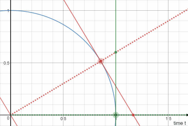

A spacetime diagram is essentially a position-vs-time diagram (as opposed to a spatial diagram of moving boxcars). By convention, the time axis runs upwards instead of to the right, as in PHY 101. The usual stumbling block is how to motivate and determine the ticks along lines that are not parallel to the coordinate axes.
Here's my introduction to spacetime diagrams, motivating a graphical method using light clocks.
https://www.physicsforums.com/insights/spacetime-diagrams-light-clocks/
and more recently
https://www.physicsforums.com/insights/relativity-on-rotated-graph-paper-a-graphical-motivation/
which uses the Doppler effect and what you call "reciprocity" to develop special relativity.
My answer to https://physics.stackexchange.com/questions/383248/how-can-time-dilation-be-symmetric
uses diagrams like this to display the reciprocity
which is analogous to what happens in ordinary Euclidean geometry
(using https://www.desmos.com/calculator/wm9jmrqnw2 with E=-1 ).
Dale said:
Yes.
The essence of the first diagram is essentially what @Dale is suggesting, with [itex]\gamma=5/4[/itex] (i.e. [itex]v/c =3/5[/itex] and [itex]k=2[/itex]), which is arithmetically nicer than either [itex]v/c =1/2[/itex] or [itex]\gamma=2[/itex].
