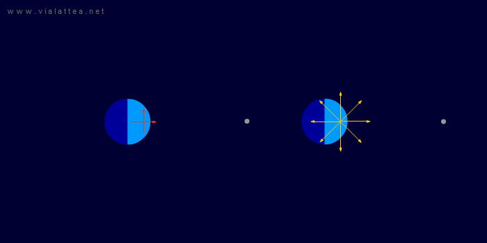

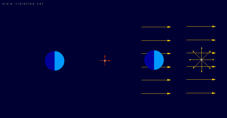

The second frame not a rotating frame, so it doesn't have centrifugal or Coriolis forces.
But it's also not an inertial frame (if the first frame one was inertial) because it undergoes centripetal acceleration. So it does have a uniform time-dependent inertial force field.
This is discussed here:
http://www.vialattea.net/maree/eng/index.htm
Rotating frame with an inertial origin has a radial centrifugal force field:
Non-rotating frame with non-inertial origin (your case) has a uniform time-dependent force field:
Rotating frame with an non-inertial origin has both:

I think A.T. has described what I am saying in the second animation. I will read the link posted.
