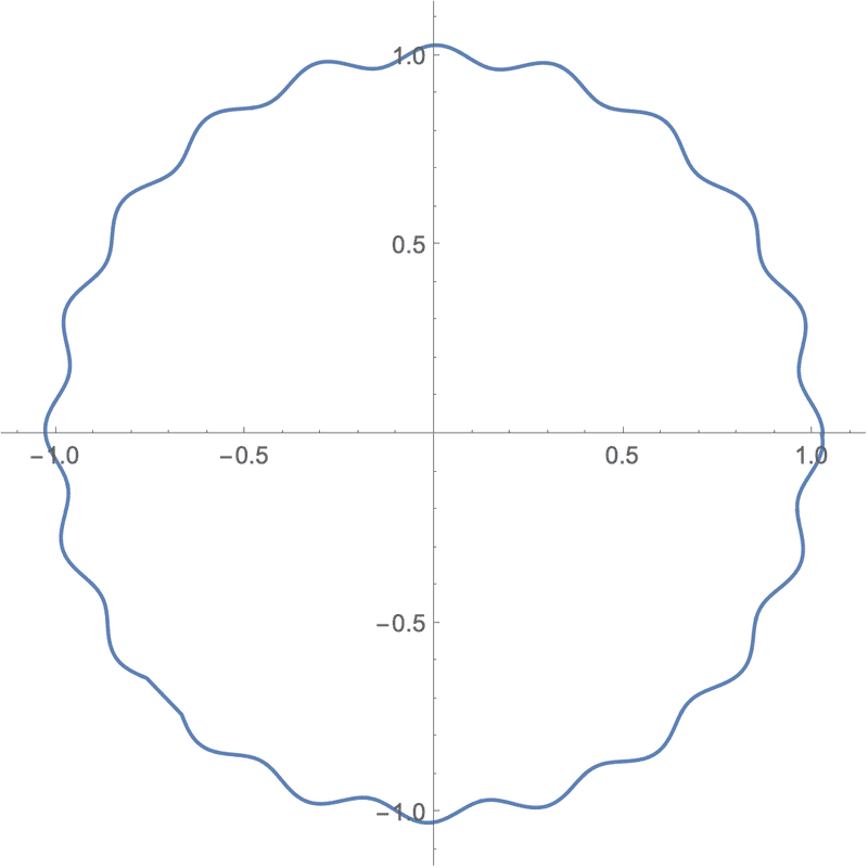

PS: when ##\omega := \omega(r)## (i.e. not constant) and still assuming no gravity and massless rod, ##\omega_{\text{osc}}## can be obtained in a really similar way as before. The answer I get is
$$\omega_{\text{osc}} = \sqrt{\frac{k \omega_0^2 + 3k\omega^2}{m\omega_0^2}} \ \text{or} \ \omega_{\text{osc}} = \sqrt{\frac{k^2 + 3mk\omega^2}{mk}}$$
I agree with your results. Here is a plot of the orbit over one revolution. The input parameters I used were
##\omega_0=10~##i.s.u. (i.s.u. = "in some units")
##\omega=0.04~\omega_0##
##R=1~##i.s.u.
##\epsilon_0 = 0.025~r_{eq}## (amplitude of small oscillations.)
The orbit appears closed but it isn't.
