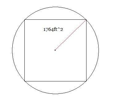

A square garden has an area of 1764 squared feet, and the gardener wants to install a sprinkler (with a circular spraying pattern) at the center of the garden. What is the minimum radius of spray the sprinkler would need in order to water ALL of the garden.
2. Homework Equations
pi*r squared=1764
3. The Attempt at a Solution
Now my question is... should r not be around 23.70 rounded up? In order for it to cover the entire garden?

To the OP, think circumcircle.

You've found the radius for a circle that has area 1764. If you draw a square with side length s and a circle (both having equal centres) with radius slightly greater than s/2 (diameter greater than s), then you'll see that their areas must be about the same but we haven't answered the problem which is to find the radius of the circle that would water the entire garden.
If the area of the square garden is 1764ft2 then what is the side length of the square? Now, where and what is the furthest distance on the square from the centre of the square?

As @Mentallic said,The center of both the circle and the square is in the same position.
Here the circle should be larger than the square to water ALL the garden
As you can see,the 1/2 diagonal of the square:Red color line,is the same as the radius of circle.Find it using trigonometry.
First fine the side length of square.Then Use pythagoras Theorem.

Yeah i know i pictured it a bit after the fact.
