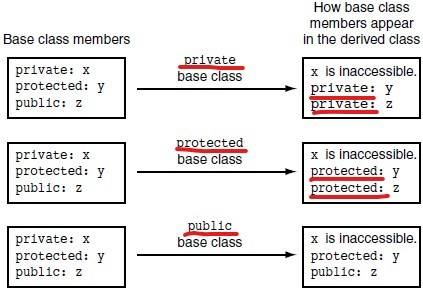

I studied about 20 pages, I understand the base class access specification as shown;
My question is why is it necessary to have private and protected base class access specification? If z is public in Base class, other programs can access z directly regardless the Derived class say it's private or protected. Is there really real use for declaring private or protected?Regarding to Constructors, is declaring constructor DerivedClass() : BaseClass() only to save some lines of declaring some default values of the variable and function. That if you are willing to type the extra lines on constructor DerivedClass(){}, you do not need to do this fancier way?
Thanks

I think this boils down to how the final API for a class will look to the user. For example I often use STL base classes. If these are left public then people are free to use the underlying container class API which pretty much keeps you from ever changing it without breaking everyones code. Keeping the underlying base class private allows you to make public only those parts you want people to use.
For small classes I'll often start by making them structs in development. In C++ structs are just the same as classes but everything is public by default. Once the API is clearer change to classes and then tweak public / protected specs as needed to make the API clean.

Well, just because the base class of your class is private doesn't remove the base class object from use by others, they just can't access the base classness of your class. So I should be able to define my own vector containers independent of your usage in your class.
There are cases when one and only one of a base class can be made. This happens in controlling hardware all the time. In cases like these one might well want to hide the constructor and not let anyone access it but you.

Unlikely. If DerivedClass inherits from BaseClass and DerivedClass is defined in DerivedClass.h and BaseClass is defined in BaseClass.h, then DerivedClass.h will have to include BaseClass.h, hence both definitions are visible to any file that includes DerivedClass.h.
The point of private or protected inheritance is not to hide information, but rather to restrict access to (i.e. restrict use of) the base class portion of the derived class.

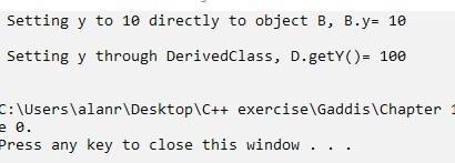

Here is a simple program that demonstrate I can change y in BaseClass even it is declared private in DerivedClass. I just put in one program. It is easy to separate to .h files and all.
C++:
#include <iostream>
using namespace std;
class BaseClass
public: int y;
class DerivedClass : private BaseClass//Declares private
public:
    BaseClass Bobj;
    void setY(int a) { Bobj.y = a; }
    int getY() { return Bobj.y; }
int main()
{//This shows I can get to y directly in BaseClass and change y.
    BaseClass B;//To direct access to y
    DerivedClass D;
    B.y = 10;
    count << " Setting y to 10 directly to object B, B.y= " << B.y << "\n\n";
    D.setY(100);//Going through DerivedClass to
    count << " Setting y through DerivedClass, D.getY()= " << D.getY() << "\n\n";
    return 0;
I first set y directly from main to 10, then I call D to change y to 100. This is the printout:
Thanks
C++:
public:
    BaseClass Bobj;
But in this example, DerivedClass has a BaseClass member variable (in addition to inheriting BaseClass). You are modifying the y variable of the BaseClass member variable Bobj. You are not modifying the y variable of DerivedClass's parent!
If I instantiate a DerivedClass called myObject:
C++:
DerivedClass myObject;
then the following are two entirely separate variables:
C++:
// inaccessible due to private inheritance
myObject.y
// accessible because Bobj is a public member of myObject, and y is a public member of Bobj:
myObject.Bobj.y
Note that even if I get rid of Bobj and directly use the parent class's y, your example still works:
C++:
class BaseClass
public: int y;
public:
    void setY(int a) { y = a; }
    int getY() { return y; }
int main()
    DerivedClass dc;
    dc.setY(5);
    int rslt = dc.getY();
    std::count << rslt << std::endl;
    return 0;
But that should not be any surprise! The functions that set and get y are public. A similar example without inheritance would be
C++:
class MyClass
public:
    int getY() const { return y; }
private:
    int y;
int main()
    MyClass mc;
    // I can use the set function to assign to mc.y:
    mc.setY(5);
    // I can use the get function to read mc.y's value:
    int rslt = mc.getY();
    // But I can't access y directly:
    mc.y = 10; // error
    int x = mc.y; // error
Of course you can always effectively bypass private by creating public get/set functions, but that is a poor design and I see no reason to do it.
In some cases there may be a good reason to have a public get **or** a public set for a private member variable, but generally not both, unless they are providing additional behavior beyond a simple read or write to the private variable.
Example: perhaps you want y to be publicly accessible, but you want your class to be thread-safe, so instead of making y public and thereby enabling it to be read/written directly, you might make y private, and create public get/set functions that lock a mutex before getting or setting the private variable.
