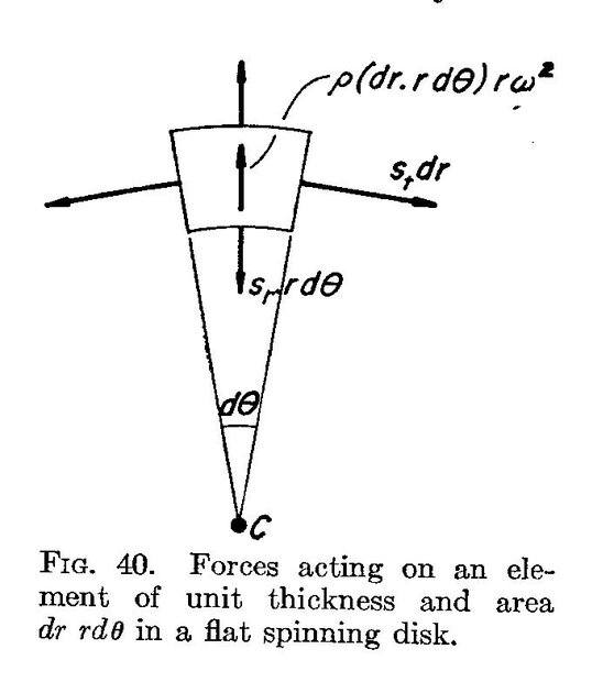

This might be easier to understand if we look at the forces on an element in a spinning disk. This free body diagram is copied from the chapter on rotating disks in Advanced Strength of Materials by J.P. Den Hartog. The book is still in print: https://www.amazon.com/dp/0486654079/?tag=pfamazon01-20.
The element has a body force due to centrifugal force on the mass, radial stresses, and hoop (tangential) stresses. The book takes several pages to cover the integration of those forces and stresses, resulting in equations which you can find by searching flywheel stress. If you find different equations, look closely at the boundary conditions - hollow vs solid center, compressive stress in center hole, disk vs constant stress design vs rim and spoke design, etc.

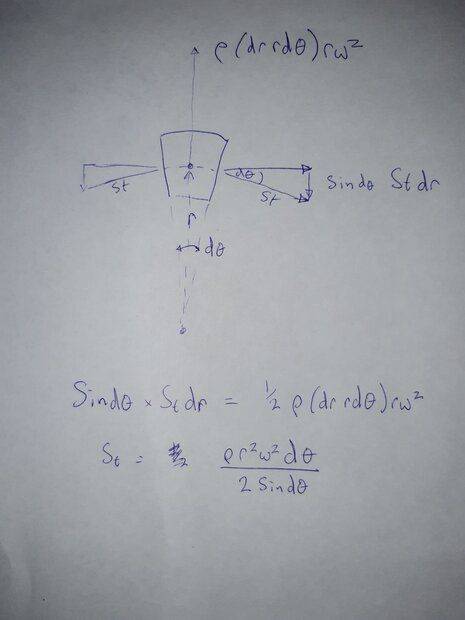

Good Day Chester,
I thought I would have a crack at the FBD. see attached- does that look right?
Being a ring rather than a disk I assumed that there is no inward radial force, not sure if that's correct.
So based on the FBD and the arising formula, it appears that the hoop forces could be huge.
Note this is based on a general thin ring, not for the "earth case", in that case you would also include gravity, as an inward force, I guess.
so given that there is a sineis also very small, it, i i small,
This is close, but not quite right. If the magnitude of the tension is T, the tension vectorially is ##Ti_{\theta}## where ##i_{\theta}(\theta)## is the unit vector in the ##\theta## direction. So the force balance should read: $$(Ti_{\theta})_{\theta+\Delta \theta/2}-(Ti_{\theta})_{\theta-\Delta \theta/2}=-\rho(r\Delta \theta)r\omega^2i_r$$Differentially, this becomes $$T\frac{di_{\theta}}{d\theta}=-\rho r^2\omega^2i_r$$
