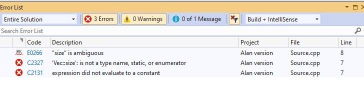

This is the error list:
Please advice whether this is the right way to have deep copy.
Thanks
