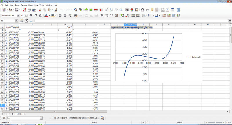

I became curious about the following problem from a discussion in another thread:
After a bit of study I concluded that the meaning of the assertion below regarding some specific real number rl P has the meaning which follows it.
Assertion: "r is not expressible in terms of radicals."
Meaning: r is not expressible in terms of a finite application of a collection of operators (+, -, ×, and /, together with any of the n-th roots (where n a positive integer) ), where these operators are applied to integer operands, or to expressions of the same kind.​
If this meaning is incorrect, I hope someone will correct it.
The article
contains the following text:
An example of a quintic whose roots cannot be expressed in terms of radicals is x5x + 1 = 0.​
This simple example of a Bring-Jerrard quintic equation has one real root, with an approximate value of
r = -1.16730397783.​
This can be seen in the attached PNG file.
My QUESTION IS:
What would a proof that "r is not expressible in terms of radicals" look like?​
I have no idea whatever how one would go about proving the non-radical nature of just this one example.
Any help would be much appreciated.
