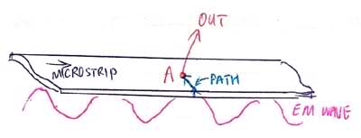

This is actually a continuation of another thread here:
https://www.physicsforums.com/showthread.php?t=618868
I don't want to hijack that thread. But that thread make me think about how the signal travel.
Let's consider a pcb trace on top of a ground plane...which is microstrip. EM wave travel in the dielectric guided by the microstrip structure. If you probe on top of the trace, you get a signal. You solder a connection on top of the trace, you get the signal.
My question is what is the path from the EM wave traveling between the bottom of the trace and the ground plane, to the top of the trace ( the other side). Remember from post #7 of Studiot, the velocity of the EM wave in good conductor ( the trace) is much slower.
[tex]v = \sqrt {\frac{{2\omega }}{{\mu \sigma }}}[/tex]
1) So if the EM wave travel from the bottom of the trace to the top through the metal, not only should the EM wave get attenuated, but also delayed.
2) Say if the EM wave travel from the surface from the bottom, to the side and then to the top, it still have delay. Particular if you think of a case where the driving circuit is on one side of a large thick metal plate, you can connect the return of the driver on one side of the plate, the input of the next stage on the other side of the plate. You don't get extra delay. If it is true the EM wave travel on the surface, the wave has to travel a long distance if the plate is big.
At high frequency, the wave length is very short, even a trace width will cause a change in phase...delay if you want to call it.
I don't know what to think in this case.

Thanks for your reply, I still don't quite get this, how does the signal go through the metal plate/trace from the bottom surface to the top surface.
It doesn't "go through". It travels as fields between the conductors and may taker the long route from one side of the conductor to the other. In the case of a 'good' coax, the signal goes all the way to the end termination and then may travel along the outside, back to the point of interest if the termination is not perfect.

So if the signal don't go through the metal strip, then it has to travel on the surface from the bottom, around the edge and on the top surface to the "pickup" point? I draw a diagram of a section of microstrip where the signal is pick up at point A. I showed the EM wave between the bottom of the microstrip and the ground plane in pink. The path from the bottom to point A in green. So this is what you mean?
153740[/ATTACH]"]

This link has a good diagram of the fields on an idealised piece of microstrip.
Sorry it's taken a while to come back.
The thickness of a typical pcb land is 25 - 50 micrometres.
The skin depth at 2.4Ghz in copper is about 1.5 micrometres, beyond which the signal is effectively zero.
So at this frequency the signal does not travel through the land from bottom to top.

Thanks for both your reply. I was looking at the diagram in the link Sophiecentaur provided, notice the B is circling around the trace? From
[tex]\int_C \vec B \cdot d\vec l'= \mu I[/tex]
This get me thinking about the I being surface current, is also exist on the top of the trace as well as on the underside. This will be a sure way to communicate the current to the top. But still my next question is how long it take for the B to communicate from the bottom ( where the EM wave travel) to the top. Is there a propagation delay in the B field?
To clarify, I am not talking about the propagation of the EM wave. I am referring to the B line travel from the bottom of the trace to the top. ie: Let's call propagation of EM wave in z direction and [itex]\vec B =\hat \phi B_{\phi}[/itex]. My question is how long it takes for B to go from [itex]\phi[/itex] = 0 to 180 deg. I am not even sure I can look at it this way, bottom line, I am confused!:confused:
I do believe that the diagram in Sophiecentaur's link is a section across the microstrip and ground plane, with the signal traveling into the plane of the paper.
The electric field is shown as the blue lines. The magnetic field will be closed contours around the strip, like the red ones marked equi potential lines are.
That's the typical field pattern of a microstrip. I understand microstrip is not perfect where the velocity at the top and the bottom is slightly different.
But I want to find out how the signal goes from the EM wave to the top of the trace. So far, I can see the closed loop magnetic field lines induce current on the top side of the trace. But still my question is whether it is instantaneous or still having a delay.

Sophiecentaur, please confirm or deny my understanding of the diagram you linked to.
If what I am saying is correct and the signal is traveling ar right angles to the diagram it is not localised and so does not travel from one point on the section 'around the rectangle' - in effect it is already there when it arrives at the plane of the paper.

I am referring to my post #12. I am not talking about the EM wave propagation delay traveling down the stripline. I am talking about each of the B closed circle. The EM wave travel between the bottom of the trace and the ground plane. The B component of the EM wave is a closed loop around the trace as in your diagram. Say when the signal first arrive at a point on the stripline, the B just started. My question is whether there's a delay of the B field from [itex]\phi[/itex]=0 to [itex]\phi[/itex] = 180 deg. This is not EM propagation. Please refer to post # 12.
From the B circling the trace, surface current exist on both the top and the bottom surface of the trace. Ultimately, my question is whether the top current and the bottom current are exactly the same phase or whether the top current has a delay from the bottom current.
You need to think in 3D for this.
I know this is a tedious question. Everyone know you can pick off a signal by solder on the top of the trace. I wonder anyone stop and think about how and why that happen!
I don't want to comment further until Sophiecentaur has confirmed my understanding of his picture, in case I am barking up the wrong tree.

My comments have nothing to do with launching a wave and everything to do with the geometry of the situation.
I am suggesting that the picture you posted is a cross section through an already fully developed (wave? signal?) (travelling?) at right angles to the plane of the section.
Yes. It shows the 'static' situation. Isn't that clear in the text? I'm afraid I recognised it immediately and didn't search for the detailed description. It shows that the field is stronger between the plates - not surprisingly.
Interestingly, when discussing what happens when you pick a signal off the line, it is the potential that makes the difference and not the fields. This is an old chestnut for ordinary circuits too.
