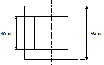

Question:
A bar has a unknown tensil load. A gauge shows that the strain is 400x10^-5.
Work out the Stress & Tensile Load (there should be an image attached of the beam. Also the Youngs modulus is given as 180GNm^-2, but I believe this is for a later part of the question)
Relevant equations:
The question does not come with any equations, but I believe I have to use the following.
M/I= σ/Y = E/R. However, I never got the hang of using this formula, and so I'm having some trouble.
The attempt at a solution:
So far all of my attempts have come up trumps, mainly because I'm not sure how to use the formula, or if its the correct one to use. Any help is apriciated.
Thanx :D
This is not a bending problem...the bar is under an axially applied tensile load, T, causing tensile stresses T/A. What is the relationship between stress and strain using Young's modulus and a linear curve?

If you know the strain, you can get the stress from using the Young's Modulus. Then the force using the definition of stress.
First of all, thnx, and in my question the strain measured by the gauge is an axial strain.
Secondly. Soo I need to work out the strain first. Ok. This is a formula that that I found on a different thread asking a similar queston: σ = Eε (Strain = Young's modulus x Axial strain)? Is this the way that I get the Strain? And then after the stress?

Thanx, don't know what I was going on about then. The more I go into it, the more it all seems the same to me. Ill use this n put what i get on
Ok, so I'v worked out the stress in the beam :
Stress = Young's modulus x Axial strain
Stress = 400x10^-5 x 180
Stress = 0.004 x 180 = 0.72 (dont know what units to put it in though :S)
Now I have to work out the tensile load that is applyed. Is there a formula for doing this, because rock.freak667 says to use the deffinition of stress but I am not sure what that is.

Stress is measured in N/m2, which is a force/area :wink:
Be careful with your math. Strain is a dimensionless quantity given as 400(10^-5). Young's modulus is given as 180 GN/m^2, which is 180(10^9) N/m^2.
Right. thanx. So this is what I have now:
(400x10^-5) x (180x10^9) = 720000000N/m^2
Now this is correct I hope, how do I go about workng out the magnitude of the tenslile load? (dont really want to keep asking loads of questions, sounds like I'm just leaching but I'm soo stuck :S)
That stress looks a bit height, but you'll need to multiply by the area where the force is acting to get the force.
Great thanks the both of you, I think I understand it now :D

(also I am assuming that when you say "force is acting" its the 720000000N/m^2 answer I gave and the "get the force" force is the tensile load)
My words did sound quite confusing.
Your stress= Force/Area so that the tensile load is the force. So multiply by the area.
