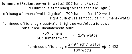

That's because Radiant Flux, measured in watts, is for optical wavelengths from Ultra Violet to Infra Red (.01 to 1000 μm) and all other wavelengths produce a negligible amount of energy. So the marked wattage on a incandescent lamp IS the Radiant Flux.
[PLAIN said:
http://hyperphysics.phy-astr.gsu.edu]That[/PLAIN] is, a 60 W incandescent lamp would have a radiant flux of 60 W, and a 250 W Mercury vapor lamp would have a radiant flux of 250 W.
I found just one spectral graph giving total watts emitted per nm of wavelength. By summing the area under the curve, this gave 60W radiated and therefore 40W conduction/convection.
The flux seen by the human eye is called Luminous Flux, measured in lumens, and the eye doesn't see every wavelength equally, so your summing won't give you the correct answer. i.e. you must factor the Radiant Flux by the sensitivity of the human eye (683 lumens/watt).
Image compliments of http://hyperphysics.phy-astr.gsu.edu

1. "So the marked wattage on a incandescent lamp IS the Radiant Flux." This is false. Marked wattage is power consumption.
"For years, people have chosen light bulbs by the watt, learning over time about how bright a typical 40-watt or 60-watt bulb is. But wattage tells you only how much energy a bulb uses — not how bright it is." Source amongst others http://www.consumer.ftc.gov/articles/0164-shopping-light-bulbs
2. "That's because Radiant Flux, measured in watts, is for optical wavelengths" This is false Radiant flux is for all wavelengths, luminous flux is for eye-visible wavelegths. In general -RAD- and -LUM- are dedicated to ALL and VISIBLE wavelengths respectively For example irradiance and illuminance, radiance and luminance
3. "That is, a 60 W incandescent lamp would have a radiant flux of 60 W, and a 250 W Mercury vapor lamp would have a radiant flux of 250 W." This is false. The person who wrote this should be notified of his mistake, but maybe he just wants to make it simple for the layman. A 60W lamp consumes 60W of electricity and its radiant (all wavelength) flux would, I guess very very approximately, be around 36W, the rest lost in heat conduction and convection.
Your reference is confusing you. Brightness is a photometric measurement dealing with the wavelengths the human eye sees. If you put all/most of the bulbs energy in a few visible colors (what the eye sees), like a CFL does, sure you can get the same "brightness" in lumens while consuming less energy.
Isn't that what I said?
... Radiant Flux, measured in watts, is for optical wavelengths from Ultra Violet to Infra Red (.01 to 1000 μm)
.01 to 1000 μm pretty much covers all emission wavelengths.
and
The flux seen by the human eye is called Luminous Flux, measured in lumens, and the eye doesn't see every wavelength equally,...
So you must agree.
You need to study the difference between Radiometry and Photometry.
So if you know everything about the subject, why did you start this thread? Actually most of the radiant flux is from the Infra Red wavelengths which you can't see and is the least energetic part of the bulbs spectrum; hence is a smaller contributor to the total radiant flux.
