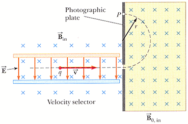

Consider the mass spectrometer shown schematically in Figure P19.30. The electric field between the plates of the velocity selector is 850 V/m, and the magnetic fields in both the velocity selector and the deflection chamber have magnitudes of 0.910 T. Calculate the radius of the path in the system for a singly charged ion with mass m = 2.18 x 10-26 kg. (Hint: The figure is of a mass spectrometer. Charged particles are first sent through a velocity selector. They then enter a region where a magnetic field B_0 (directed inward) causes positive ions to move in a semicircular path and strike a photographic film at P)
m
http://www.webassign.net/sercp/p19-30.gif
r = mv/qB
I know that I am suppose to use the above formula but I am having a problem finding v. I am not sure what formula I am suppose to use to find the velocity with the given number.
Any help would be appreciated

This is much simpler than it seems:
The particle travels in a straight line with constant velocity while in the magnetic and electric fields. These two forces cancel out. They will only cancel when the particle has a certain velocity because magnetic force is proportional to velocity. You can then solve for radius once you sum up the forces and put the velocity in terms of the electric field

They are antiparallel and cancel each other out. You seem to know your calc, but this is an APB style question and all you need are the fundamentals
The right hand rule tells us that the velocity of the particle, the magnetic field lines, and the force on the particle due to the magnetic field are all mutually perpendicular.
Place your right fingers in the direction the particle is moving. Now curl your fingers in the direction of the field while keeping your wrist in the same position. If you do this corectly, your thumb should point up, the direction of the magnetic force.
Once the particle leaves the magnetic field, something interesting happens. The force on the particle is always perpendicular to the velocity as stated before. This should sound familiar as this is the way centripetal force works. The equation in the first post was derived from qvbsin90 = mv^2/r , because the magnetic force is the centripetal force.
This brings us back to the original question. How fast is it going? In order to be traveling in a straight line in the beginning, the upward magnetic force must be equal in magnitude and opposite in direction to the downward electric force. qvBsin90 = qE. Nothing perpendicular about that

Okay, i finally got to working on this problem again with another classmate and came to this.
I am not sure if this is correct but this is what i came up with
Fm = Fe so,
qvB = qE
V = E/B
so I found the constant velocity which is 850/.910 = 934.07 m/s
after it travels into the reflector that is when the velocity change.
that is when i thought of cosine and sine but not sure how to do that. I am thinking its
Vcostheta + Vsintheta = Vfinal or cosV + sinV = Vf
that is how far i got and stop since i didnt want to confuse myself. but if i find the Vf i can then use the r = mv/qB

The particle is accelerating in a circle, but its velocity is only changing direction. Force is perpendicular to velocity, so you can just plug 934.07 m/s into your equation because its constant
Thanks for all the help and explanation and I was finally able to get the answer correctly.
