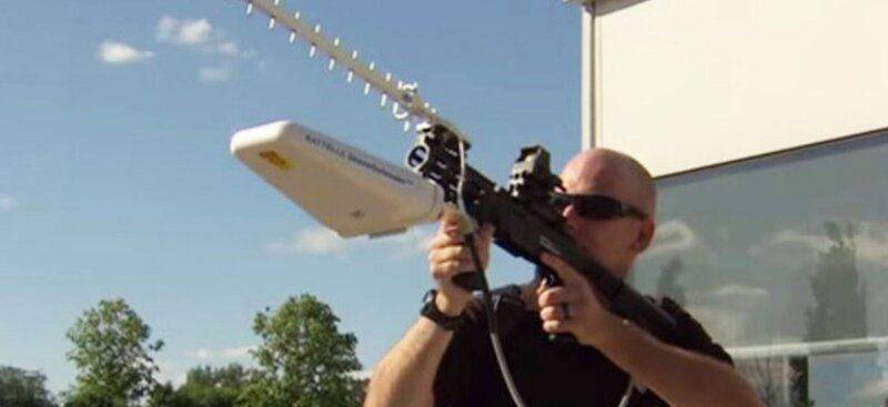

Military have stuff like this, so you know they're aware of the situation :-)
(Yes, that's a quadcopter jammer)
