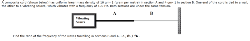

Please see below
v = λ.f
Is the answer 1? Because the cord is connected to vibrating source and it vibrates with a frequency of 100 Hz so section A and B have the same frequency
Thanks
songoku said:
Homework Statement: Please see below
Relevant Equations: v = λ.f
Thanks
Either it is a trick question or they meant to ask for the ratio of wavelengths.
Yes, the frequencies must be the same. The speed of the waves and the wavelengths will differ.
Thank you very much haruspex and Orodruin
