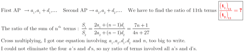

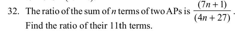

The ratio of the sum of ##n## of two APs is ##\dfrac{(7n+1)}{(4n+27)}##. Find the ratio of their ##11^{\text{th}}## terms.
1. In an AP with first term ##a## and common difference ##d##, the ##n^{\text{th}}## term is ##t_n=a+(n-1)d##.
2. For the AP in (1) above, the sum of the first ##n## terms is ##S_n = \dfrac{n}{2}\left[ 2a + (n-1)d\right]##
Statement of the problem :
I copy and paste the problem as it appears in the text to the right.
Attempt : I must admit I didn't get far, but below is what I did. I use ##\text{MathType}^{\circledR}## hoping am not violating anything.
Request : A hint would be very welcome.
You want this
$$\frac{(t_1)_{11}}{(t_2)_{11}}=\frac{a_1+10d_1}{a_2+10d_2}$$
You know this
$$\frac{(S_1)_{n}}{(S_2)_{n}}=\frac{2a_1+(n-1)d_1}{2a_2+(n-1)d_2}=\frac{7n+1}{4n+27}$$
Let ##n=21## in it.
For an AP we have [tex] S_n = an + \frac{dn(n-1)}{2} = \tfrac12n(nd + (2a - d))[/tex] which you seem to have found.
If @martinbn's method were not available, you could say that [tex] \frac{S_n^{(1)}}{S_n^{(2)}} = \frac{nd_1 + (2a_1 - d_1)}{nd_2 + (2a_2 - d_2)} = \frac{C(7n + 1)}{C(4n + 27)}[/tex] must hold for each [itex]n[/itex], so that [itex]d_1 = 7C[/itex], [itex]2a_1 - d_1 = C[/itex] etc. where [itex]C \neq 0[/itex] is a common factor which will cancel when you calculate [tex] \frac{a_1 + 10d_1}{a_2 + 10d_2}.[/tex]

Thank you @martinbn , @pasmith and others. I can solve using @martinbn 's suggestion in post #2.
I am required to find ##\dfrac{(t_1)_{11}}{(t_2)_{11}}=\boxed{\dfrac{a_1+10d_1}{a_2+10d_2}}=?##
I am given however that ##\boxed{\dfrac{(S_1)_{n}}{(S_2)_{n}}=\dfrac{2a_1+(n-1)d_1}{2a_2+(n-1)d_2}}=\dfrac{7n+1}{4n+27}##
The two boxed expressions above can be made to match if ##n = 21## in the second result.
Putting ##n = 21##, we obtain ##\mathbf{\dfrac{(t_1)_{11}}{(t_2)_{11}}}= \dfrac{a_1+10d_1}{a_2+10d_2} = \dfrac{7\times 21+1}{4\times 21+27} = \mathbf{\dfrac{148}{111}}##
This is the answer and it matches with the text. ##\checkmark##

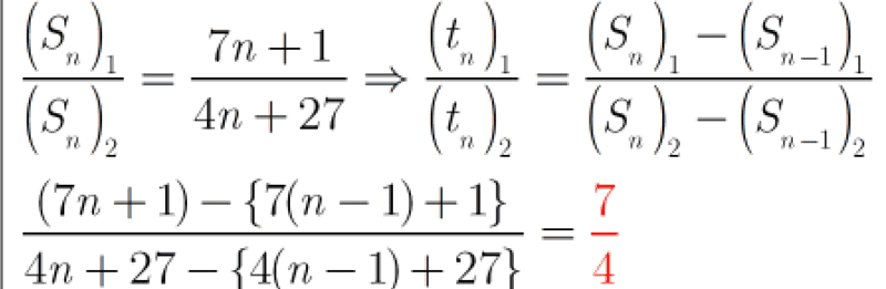

Doubt : However, we also know that ##t_n = S_n - S_{n-1}##. Can this fact be used to find the answer?
Arguing from my doubt above, I do the following :
The answer ##\dfrac{7}{4}## is incorrect.
A hint as to where I have gone wrong above would be very welcome.
You don't know if ##(S_n)_1=7n+1## and ##(S_n)_2=4n+27##. You just know what their ratio is.
Yes, so I was suspecting. Can we find what is ##(S_n)_1## from the ratio ##\dfrac{(S_n)_1}{(S_n)_2}##?
As I showed in my post, [tex](S_n)_i = \tfrac12 n(2a_i + (n-1)d_i) = \begin{cases}<br /> \frac12Cn(7n + 1)& i = 1 \\<br /> \frac12 Cn(4n + 27) & i = 2 \end{cases}[/tex] for some common factor [itex]C \neq 0[/itex] which we cannot determine. However, since we only want a ratio, it will cancel.
Then [tex]\begin{split}<br /> \frac{(S_n)_1 - (S_{n-1})_1}{(S_n)_2 - (S_{n-1})_2} &= \frac{ n(7n+1) - (n-1)(7n - 6)}{ n(4n + 27) - (n-1)(4n + 23)} \\ <br /> &= \frac{14n - 6}{8n + 23}. \end{split}[/tex]
