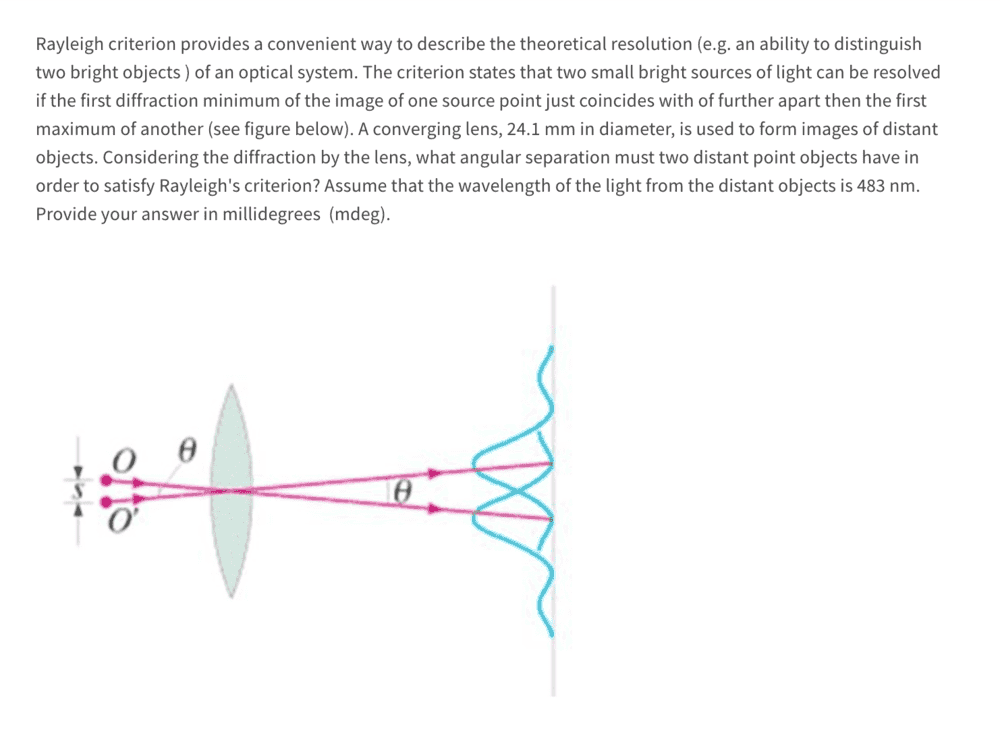

All looks good until you get to the end and multiply the angle by two. There is no need to multiply by 2. Look at the diagram. Peak 1 is located at the first minimum of peak 2. That is a single multiple of the angle to the minimum. Yes, peak 2 is located at the first minimum of peak 1, but that is the same angle, not an additional angle.
P.S.: I like radians where for small angles sin(theta) ~= theta. Makes it easier to check the math, among other things.

Plus I've just realized I've been using the wrong wavelength. It should have been 483 nm NOT 491 nm. Making that adjustment I get the angle to be 1.4 millidegrees now
