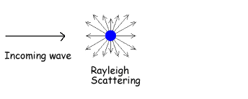

Like in the image I've posted, if I integrate the intensity over the whole solid angle before and after the scattering, what I get is the same result:it is the energy carried per unit time but if I measure this quantity without integrating, so per unit time and unit solid angle, before scattering I'd obtain a greater number than after scattering since in the second case the wave is more "spread" in the space, so if I only "concentrate" over a small portion of the solid angle what I measure is just one of the many rays the incident wave splits in, is that right?
Last thing: the intensity after the scattering is greater for shorter wavelenghts, what does it mean in terms of energy per unit of solid angle? In other words, if the blue goes into scattering or the red goes into scattering, talking about the definition of intensity, what are the physical differences we can note after the scattering? Is red light less "spread out" after the scattering? If I wanted to draw it, how should I illustrate it? How can I imagine the intensity of red light be smaller? How the energy per unit of solid angle and time could be smaller than the one we get from blue scattering? Hope this is clear.

Like in the image I've posted, if I integrate the intensity over the whole solid angle before and after the scattering, what I get is the same result:it is the energy carried per unit time but if I measure this quantity without integrating, so per unit time and unit solid angle, before scattering I'd obtain a greater number than after scattering since in the second case the wave is more "spread" in the space, so if I only "concentrate" over a small portion of the solid angle what I measure is just one of the many rays the incident wave splits in, is that right?View attachment 304340
If you consider scattering by a single molecule, you are talking about a different quantity under the same name "intensity". In this case the intensity decreases as the inverse square of the distance from the scatterer. When looking at the blue sky, this decrease is compensated by an increase in the number of scatterers (molecules).
No, the red light is spread out in the same way as the blue light. The angular distribution emerging from a single molecule is exactly the same. It is only the total number of photons that is less (relative to the number in the incident beam). You could draw shorter arrows if you wanted to illustrate it.
Hope it's become a little bit clearer. :smile:

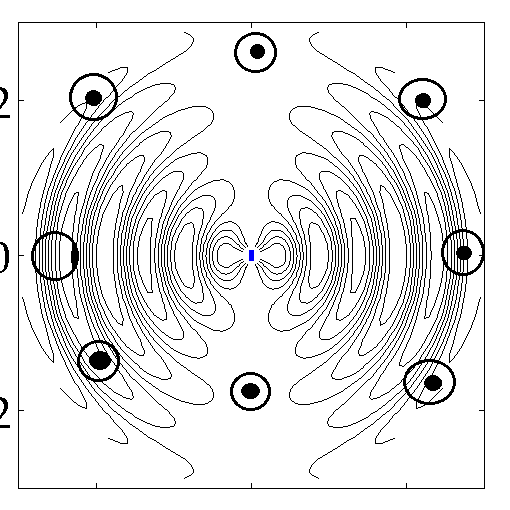

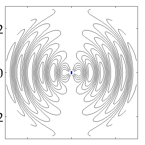

It is very difficult for me at this point to understand the meaning of image I've posted, as far as I understand the arrows represent the Poynting vector of the scattered light depending on where it is issued which can vary with the scattering angle, being maximum in the direction of the incident light and minimum in the orthogonal direction. Since the scattered light is emitted by an oscillating induced dipole I think it must be a spherical wave so, does it make sense to talk about direction of a spherical wave?
The direction of a spherical wave is radially outward. Dipole radiation is a spherical wave far field but it is not spherically symmetric : nothing is emitted along the z axis (conventionally chosen as the dipole direction), while most comes out symmetrically equatorially (x-y plane). So your picture of the scattering is incorrect. Also (again) most of the sunlight suffers no scattering at all.
Thank you for your answer, maybe I'm getting it. Let me ask you a question, is there an analogy between these tow images? The one on the left is the radiation emitted by an oscillating dipole and the other one is the Rayleigh scattering intensity, is the scattered intensity that way because of the form of oscillating dipole radiation?
These are different representations of basically the same phenomenon. The second is more of "sketch" of energy flow of the process I guess (it is difficult for me know).
The first is a quantitative graph showing an intermediate range snapshot of the electric field associate with oscillating dipole radiation. To understand why they can be the same process requires firm knowledge of Maxwell's equations.
I thought you could relate the scattered intensity to the shape of the electric field generated by an oscillating dipole since I find them very similar. As far as I understand the second image represents Poynting vector so it's like the representation of the magnitude of the intensity of the scattered wave and since this last one is produced by an oscillating dipole I thought that distribution of intensities descends from the first image.
That's pretty much what I said. The stellate "graph", without further explanation, could be a sketch of a porcupine.
Precisely what do you wish to know? Your original questions have been thoroughly answered I believe.
