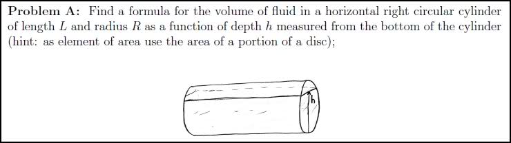

Really hard Volume Question. URGENT!
Can someone help me with this question? I don't know where to begin. I don't want the answers, just hints in the right direction

I can suggest:
http://img101.imageshack.us/img101/1570/49965064rf9.jpg And Volume = area*length
Call z the axis which h belongs to. You have to find an expression for the area of the rectangle obtained by intersecting the cylinder with an horizontal plane as a function of z and integrate this area from 0 to h.
The area of the disc (what's inside the circle) from -r to h, where h is between -r and r can be figured out by doing half a circle at a time. The function is sqrt (r^2-x^2). Since a disc is symmetrical just find the area above the x-axis and multiply by 2. So the fun part here is finding out what the integral is.

I think it can be solved without integration using bunch of trigonometry and sector, triangle area formulas
Sure area 2 is a fraction of pi r^2. I bet the fraction formula as a function of h is not simple. Area 1 is + when h is above the center of the circle and - when h is below the center. I think I'll stick with my integral since I've already solve a related problem: The probability of intersection between a tossed square and a target disc.

What you actually need is the length of the segment obtained by intersecting the circle x^2 + z^2 = R^2 [\tex] with a straight line z = const. And this is given by <br /> <br /> &lt;br /&gt; b(z) = 2 \sqrt{R^2 - z^2}&lt;br /&gt; [\tex] &lt;br /&gt; &lt;br /&gt; Thus, let L be the height of the cylinder, the area of the rectangle is given by&lt;br /&gt; &lt;br /&gt; &amp;lt;br /&amp;gt; A(z) = L b(z) = L 2 \sqrt{R^2 - z^2}&amp;lt;br /&amp;gt; [\tex] &amp;lt;br /&amp;gt; &amp;lt;br /&amp;gt; And then the volume of the water&amp;lt;br /&amp;gt; &amp;lt;br /&amp;gt; &amp;amp;lt;br /&amp;amp;gt; V(h) = \int_{-R}^{h} A(z) dz&amp;amp;lt;br /&amp;amp;gt; [\tex]

(1/2(pi r^2) + 1/2(pi (r-h)^2 ) * l
would that work?
