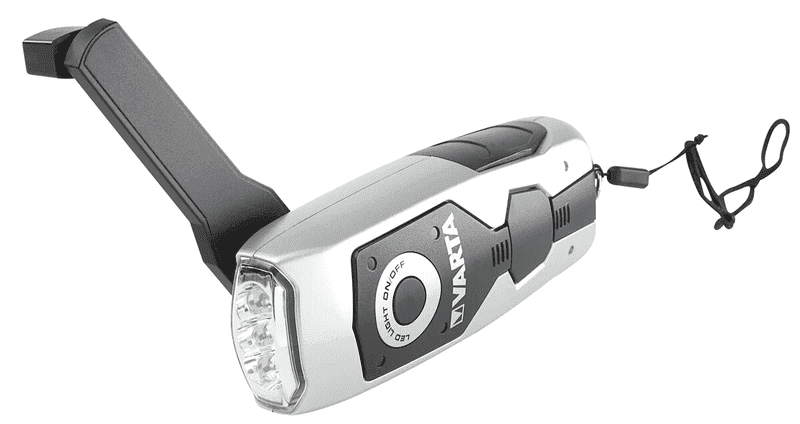

I have one of these:
Silver and black hand-crank LED flashlight with a folding handle, a VARTA logo, and an ON/OFF LED LIGHT button, with a dangling cord loop attached.
and while the manufacturer says that 1 minute of cranking can give you 30 minutes of light, I have tired my arm long before I can get a significant amount of power.
