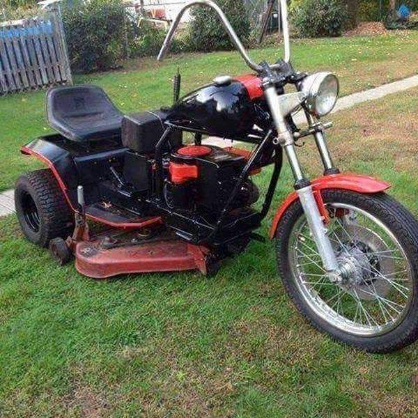

One of those cut me up in heavy traffic the other day.dlgoff said:
