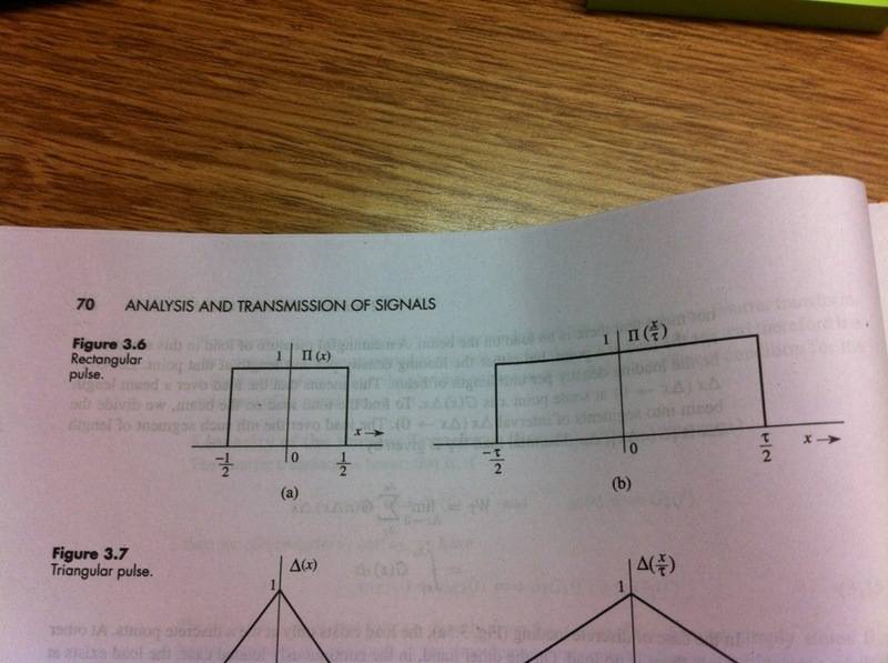

Ok so i finally found what the books notation means when using ##∏##
Taken from the book:
Unit Rectangular Function
We use the pictorial notation ##∏(x)## for a rectangular pulse of unit height and unit width, centered at the origin as shown in Fig 3.6a
##∏(x)= \left\{ \begin{array}{ll}
1 & \mbox{|x|≤ 1/2}\\
0.5 & \mbox{|x|=1/2}\\
0 & \mbox{|x|>1/2}.\end{array} \right. ##
Notice that the rectangular pulse in fig. 3.6b is the unit rectangular pulse ##∏(x)## expanded by a factor of ##\tau## and therefore can be expressed as ##∏(x/ \tau)##. Observe that the denominator ##\tau## in ##∏(x/ \tau)## indicated the width of the pulse.
So I don't believe that it means the "product." that being said I am not sure I fully see how to apply this..
