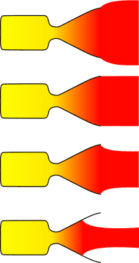

Liquid-fueled rocket engines almost always seem to have lower specific impulse at sea level than in a vacuum.
I know of one reason:
1. Nozzle expansion. Many engines are optimized for higher-altitude performance, so their nozzle is over-expanded for lower altitudes. I would say more, but I think most people familiar with the topic are rather familiar with this one:
Underexpansion - the nozzle doesn't expand far enough and the gas plume exerts force on the air instead of the nozzle, wasting energy from the combustion.
Good expansion - all of the exhaust is going directly to the right in the picture, so the change in momentum is maximized.
Overexpansion - the nozzle goes too far, and ends up re-compressing back to ambient atmospheric pressure. As a result, some momentum is going inward and rightward (right in the picture) motion isn't maximized.

I recently did a numerical study (project for grad school) on altitude compensating nozzles. For it, I looked at an RP-1/LOX powered rocket. The theoretical best case Isp was ~280 seconds at sea level and ~360 seconds at 60 km. Bell nozzles (with fixed expansion ratios) had Isp's ranging from ~75 seconds to ~270 seconds at sea level and from ~305 to ~335 seconds at 60 km. The variation depended on the expansion ratio, and the design altitudes ranged from ~6,000m to ~26,000m.
Once again, if matching nozzle expansion with chamber pressure / ambient pressure is all there was to it, then you could have a combustion chamber work at 0.5 atmospheres, have a shrinking nozzle, and still get no overexpansion or underexpansion - but that clearly wouldn't actually create thrust. So I think something is missing... The same thing that could give the SSME's 450 seconds of ISP at sea level, theoretically.
The combustion chamber has to have a pressure higher than ambient in order to drive the exhaust acceleration. Even at the nozzle exit, if the pressure is too low (compared to ambient), it can cause separation (that's the fourth picture in your graphic above). In the SSME, some serious design work was done around the lip of the nozzle in order to allow an exit pressure down to 4 psi (averaged across the exit plane, the pressure at the lip is actually higher to prevent separation).
