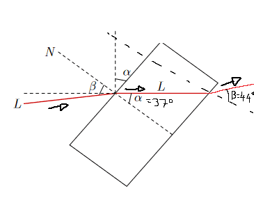

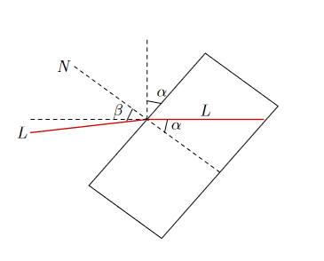

A container hold oil with refraction index of 1.4. A flintglass? (maybe a wrong translation) is submerged into the oil, with a incline of a=37◦ flintglass index is 1.62. Laser is shot at the flintglass which then exits into the oil, what is the angle when the laser exits the glass?
n1sinΘ1=n2sinΘ2
Hello, hopefully the question made sense, it was hard to translate. i attached a photo about the question.
I started with n1=1.4, sinΘ1=37◦ and n2=1.62
1.4(sin(37◦))=1.62sinΘ2
1.4(sin(37◦))/1.62=sinΘ2
arcsin(0.52)=31.34◦
Is it calculated correctly?

Also: I see ##\alpha, \ \beta,\ ## but no ##\theta_1,\ \theta_2\ ## ... ?
BvU said:
Hi,
What question ?
oops, my bad, edited it to include the question :D
So the top ##\alpha## I can understand. But why and how the other one?
If you can find ##\beta##, you have nearly completed the problem!
It is not clear (as noted by @BvU ) what angles ##\theta_1## and ##\theta_2## are.
Hi @BvU. I'm guessing that the top of the block is inclined clockwise by ##\alpha## to the vertical and the ray inside the block is traveling horizontally. As a result the ray inside the block makes an angle ##\alpha## to the normal. Presumably it's just the way the person who wrote the question decided to set it up.

I don't quite understand why i need the b angle to answer the question
You should look at this diagram very carefully: https://www.gcsescience.com/light-refraction-glass.gif (Having oil rather than air doesn't matter here.)
Can you understand why the emergent ray is parallel to the incident ray?
Does this help you answer the question?
Ooh, so because the flintglass is submerged, the laser must have been traveling in the oil already before it hit the flintglass, and since the b angle is angle it hits the flintglass it must come out in the same angle too?

Which angle of the laser beam are you calculating? The angle to the normal at the exit point? Or the angle to the horizontal? Or the angle to to the vertical? Other something else?
(You should have a diagram clearly showing the full path of the laser beam and the angles.)

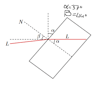

Good try. But 4 problems!
1) Your equation θ₁=sin⁻¹((n₂sinθ₂)/n₁) does not match θ₁=sin⁻¹((1.4sin(37◦))/1.62). Check your values.
2) sin⁻¹((1.4sin(37◦))/1.62) works out to be 31º, not 44º. (But 31º is wrong!)
(When you do it correctly, you will find mistakes 1 and 2 cancel!)
3) You have the wrong number of significant figures in your anwer.
4) If this is a written assignment to be handed in, you must include a diagram. Make it clear what angle θ₁ is on your diagram, or your teacher can not tell if you have found the correct angle to answer the original question. Can you post your diagram here?

Oh seems that i forgot to insert the right values, it was meant to be: θ₁=sin-1((1.62sin(37◦))/1.4)
and the answer for β would be 44º (i think significant figures mean the answers accuracy? so to say)
Would the diagram in the attached photo be sufficient?
θ₁=sin⁻¹((1.62sin(37◦))/1.4) - good
44º - good
Diagram - bad!
Going from left-to-right:
Laser beam passes through oil and is refracted at oil/glass boundary.
Laer beam passes through glass.
What does the laser beam do next? You must add this on the diagram. Include arrows on the diagram to show which direction the beam is travelling. Show the angle you are being asked to find.
44º - good
Diagram - bad!
Would this be better?
Yes – good!
The only improvements I can suggest are:
- draw arrow-heads on the light rays, as shown here: https://www.gcsescience.com/light-refraction-glass.gif
- take a bit more care drawing the normal accurately; a normal should be 90º to the surface (yours is somewhere between 80º and 90º).
Steve4Physics said:
Yes – good!
Good tips, i will definitely remember them. Thank you for all the help, I've learned a lot :)
