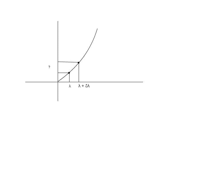

You can find an approximation of this for small ##\delta \lambda##. What is the approximate value of an integral if the function is (roughly) constant over the integration range?

still struggling on the approximation, what do you mean by that? Do i need to use trapezoidal rule for the definite integral approximation? Or something else?
In order to perform approximation how do I find y-cordinate for this function?
[tex]I=I_{0}\int_{\lambda }^{\lambda +\delta \lambda }\lambda' d\lambda = \lambda +\delta \lambda -\lambda * f(\lambda') = I_{0} \delta \lambda \lambda^3[/tex]
does that make any sense?
That is the intensity between ##\lambda## and ##\lambda + \delta \lambda## right (not exactly, but we let ##\delta \lambda## go to zero later so that approximation works).
