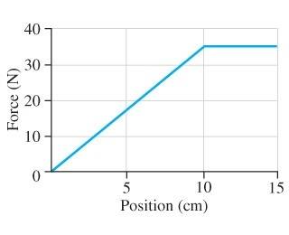

The force graphed in figure is applied to a 1.8-{\rm kg} box initially at rest at x = 0 on a frictionless, horizontal surface.
(Graph is attached)
F=ma (?)
Don't know how to relate speed to these two scalars..
You haven't stated what the problem is. At all.
I need to find the speed when position = 5, 10 and 15cm. Sorry.

How is work done related to kinetic energy.
I had to take calculus to get into this course.
A simple application of the work-energy theorem should get you on your way.
What does area under the graph represent?
So F=ma can give me the acceleration of the object, I have no units of time to convert to speed here
The area represents work done?
think about force time distance. Look at cepheid's suggestion.

Err, W=KE=1/2mv^2?

No, that is not the work-energy theorem. That is Newton's 2nd Law. The work-energy theorem relates the work done on an object to its change in energy. If you haven't encountered it before (which seems strange) you can always look it up.
By the way, the work, of course, has dimensions of force*distance, therefore its units are Newton-metres = joules.
Capncanada said:
Err, W=KE=1/2mv^2?
Im having a lot of trouble with physics...
That's pretty much it, but it should be that the work done on the object is equal to its CHANGE in kinetic energy. Therefore W = ΔKE = (1/2)mvf2 - (1/2)mvi2, where vf and vi are the final and initial velocities respectively.
but v_i will equal zero here yes?
I tried solving for when d= 5cm and it comes out and v_f comes out to 1m/s which is incorrect.

W=F*d
W=18N*.05m
W=0.9J
W=KE=(1/2)mv^2
v^2=2KE/m
v^2=2(0.9J)/1.8kg
v=1m/s

Well, it looks to me like the area underneath the curve is a triangle with a base of 5 cm and a height of ~18 N. Is the area of that triangular region just equal to base*height? Hint: what shape of region actually has an area of 18 N * 5 cm? What portion of that region is made up by the triangle?
Ahh... So I was supposed to divide the work I found in half since A=1/2b*h. Getting right answers now.
Yeah exactly. Your mistake was that W = F*Δx is NOT true if the force is not constant. In this case the force is a function of position F = F(x). The more general formula for work is W = ∫F(x)dx. That's why work is equal to the area under the force-position curve. In this case, since F(x) was linear, that curve was a triangle, and we could just evaluate the area geometrically (no need to integrate).
You can see that the more general formula reduces to the simpler one when the force is not varying. If F(x) = F = constant, then W = ∫F(x)dx = F∫dx = FΔx. You can see that, in that simpler case, the force-position curve would be flat, and the area underneath would be a rectangle (and simply multiplying base*height would work).
So, the summary is that the more general integration or "area under the curve" method always works, whereas the simpler "force*distance" method only works if the curve is flat (constant force).
