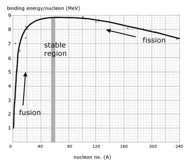

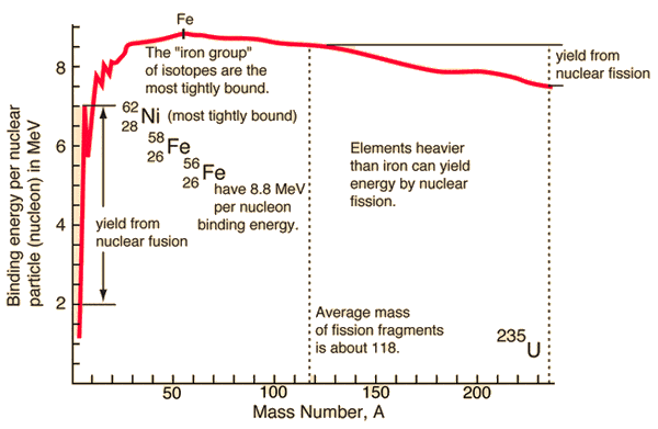

So-called binding energy isn't actually energy in the binding state. It's the energy required to break up the binding state. It's identical to the energy released in the formation of the bond.
High nuclear binding energy per nucleon represents energy lost to the environment. Look at the nuclear binding energy curve:
http://www.a-levelphysicstutor.com/nucphys-binding-energy.php
http://hyperphysics.phy-astr.gsu.edu/hbase/nucene/nucbin.html
