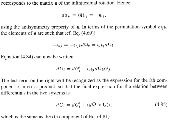

Why is ##a_{ji}dG_j'=dG_i'## ?
from the third last line below.
##G_i=a_{ji}G_j'## because a vector labelled by the space axes is related to the same vector labelled by the body axes via a rotation transformation.
If ##a_{ji}dG_j'=dG_i'##, then we are saying a vector ##dG'## labelled by the body axes is related to the same vector labelled similarly via a rotation transformation. This doesn't make sense.

They are doing the case where instantaneously the ## a_{ij} ## is the identity matrix, but it will still have a derivative. I think the equation should read, (in this case), ## dG_i=dG_i '+ da_{ji} G_j ' ##. The author was trying to say that ## dG_i ## is not equal to ## dG_i ' ## , but it appeared he might have written down something that isn't correct.

It doesn't seem like the equation is a mistake because he substituted it into (4.84) to get the equation you wrote and (4.85).
I think it's just because ##a_{ji}=\delta_{ji}##.

It seems like using ##a_{ji}dG_j'=dG_i'## I can prove that ##dG_i=dG_i'##, a contradiction.
Let ##G_{j1}'## and ##G_{j2}'## be the vector ##G## at time ##t=0## and ##t=dt## respectively, labelled using the body axes.
Then, ##dG_j'=G_{j2}'-G_{j1}'##.
##a_{ji}dG_j'=a_{ji}(G_{j2}'-G_{j1}')=G_{i2}-G_{i1}=dG_i##.
Thus, ##dG_i'=dG_i##, a contradiction.
What's wrong?
EDIT: I found the mistake. ##a_{ji}(G_{j2}'-G_{j1}')=G_{i2}-G_{i1}## is wrong.

Yes, you are correct, and what he wrote is correct. (And yes, like you said, it can even be used to get the equation I wrote.)
