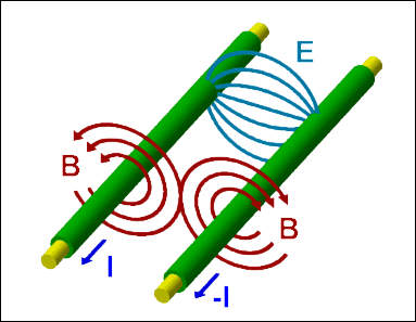

According to relativity, If magnetic field is just an electric field viewed from a different frame of reference, why is the magnetic field around the wire is circular?
This is a misleading statement at best. What is true is that electric and magnetic fields do transform into each other under Lorentz transformations. This does not mean that you can always find a frame where the magnetic field is equal to zero.

I was trying to ask why magnetic field is $$\vec{v} \times \vec{r}$$ so it has a different direction from the magnetic force. Electric field and force have same direction, but this not true for magnetic field and force.
Thanks...
Those red arrows show how an object, that has charges flowing inside of it, will tend become oriented.
In other words when a compass needle is not aligned with the red arrows, it feels a torque that tends to make it aligned with the red arrows. If we want, we can say that the torque is caused by electric repulsion and attraction.
Relativity is the reason behind the cross product operation in magnetic field and force calculation. Right?
The reason that magnetic field around a wire is circular is that we like it that way, for similar reasons as in the case of angular momentum: https://www.physicsforums.com/threads/direction-of-angular-momentum.771452/
An alternative convention might be magnetic field pointing to the direction of the Lorentz-force.
The reason that there is a cross product operation in magnetic field and force calculation is that we have chosen the first alternative not the second one.
What's physically meaningful is not the direction of the magnetic field, but the direction of the magnetic force. With a circular magnetic field, that means that for a positively charged particle moving in the same direction as the current (or a negatively charged particle moving in the opposite direction), the magnetic force is toward the wire.

Really? I have been looking for an answer like 5 days. Was that the answer? Ahhh, man.
So let me show whether I got it right.
Magnetic field could be defined as pointing to the direction of Lorentz force as well. But scientist wanted it to be like it that way. So there is no deeper meaning, no deeper scientific, relativistic reason. Right?
Umm, I wouldn't say that, exactly. What's important about the magnetic field, as I said, is not the direction it points in, but the direction the magnetic force points in. To say: "The magnetic field points in the x-direction" is just a convention for summarizing the information:
  1. A positive charge moving in the positive y-direction experiences a magnetic force in the negative-z direction.
  2. A positive charge moving in the positive z-direction experiences a magnetic force in the positive-y direction.
  3. A positive charge moving in the negative-y direction experiences a magnetic force in the positive-z direction.
  4. A positive charge moving in the negative-z direction experiences a magnetic force in the negative-y direction.
  5. (And the opposite for a negative charge)
These facts are neatly summarized by saying:
[itex]\vec{F} = q \vec{v} \times (B \hat{x})[/itex]
It's just a convention to say which "direction" the B field points in. It's also just a convention to define what the cross product [itex]\times[/itex] does. But the two conventions have to work together so that [itex]\vec{v} \times \vec{B}[/itex] is in the correct direction.

Why do you think that? You can measure the magnetic field, so it's definitely physical. What I was saying was that the DIRECTION of the magnetic field is not particularly meaningful. It's just a convention to say that the magnetic field "points" in this direction or that direction.
It's a coincidence of 3-dmensional space that the magnetic field can be thought of as a vector.
OK. Thanks for help.
In the Lorentz force, velocity of a test particle and force must be perpendicular because of the "law of conservation of energy".
In the Biot-Savart Law, veloctiy of source particle and magnetic field must be perpendicular because of the "_____________".
What would be said for that, in one phrase?
Is "convention" enough?
