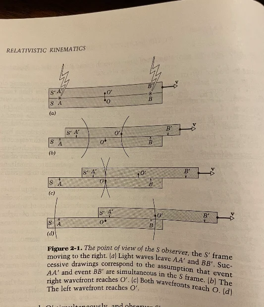

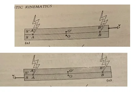

I’m attaching two figures from the book, Basic concepts in relativity and QT, by Resnick and Halliday. They are describing the relativity of simultaneity from a theoretical pov, which I understand. Basically, the lightning strikes at AA’ and BB’ can be deemed simultaneous either in frame S, in which case they will not be simultaneous in frame S’, and vice versa. Only in one of the frames are the two events simultaneous, but not in both, and this claim of simultaneity can be done by either of them.
My question is, keeping aside these analysis on paper, IN REALITY, what would the two observers say about the times (two pairs of times, btw) of the lightning strikes when they meet up sometime later? Will their recorded times show simultaneousness in one of the frames, S or S’?

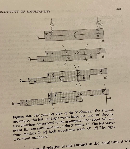

Note that the figures you've reproduced show two different experiments. In figure 2-1 the strikes are simultaneous in S, and if that experiment were carried out results would agree with that in reality. In figure 2-2 the strikes are simultaneous in S', and if this experiment were carried out results would agree with that.

Ah, I think I got it. I misinterpreted the statement that, with two frames in relative motion with each other, each can regard itself as being stationary and the other frame is moving, to be the “actual reality,” and therefore the two frames (and the two figures) are equivalent. But in REALITY, one of them is actually moving (frame S’ in fig 2.1 and S in fig 2.2) and the other is actually stationary. The observer in the stationary frame will report simultaneity and the observer in the moving frame reports non-simultaneity.

What is correct is that the lightning strike events have a particular relationship in spacetime, and in any given scenario, they can only have one such relationship. And whatever that relationship is, it will only correspond to being simultaneous in one frame. In the first scenario, that's frame S. In the second, it's frame S'. But that doesn't mean either frame is "really at rest" or "really moving" in either scenario. All it means is that the two scenarios are describing two different relationships in spacetime between the two lightning strike events. That is the only difference IN REALITY between the two.

No. The flashes are simultaneous in at most one frame. That frame will report them as being simultaneous, others will not.

The two frames are equivalent - either may regard itself as "at rest" and the other as moving. The two figures are not - they are showing different experiments, one where the light arrived simultaneously at O and one where it arrived simultaneously at O'.

Look at figure 2-1. You can see in figure 2-1(c) that the light arrives simultaneously at O. The observer there knows that the flashes were emitted from the ends of the train, equidistant from him. He received them simultaneously and he knows that the speed of light is always ##c## as measured by any observer (including himself). Hence he may conclude that the pulses were emitted simultaneously. O', however, did not receive the flashes simultaneously (see 2-1(b) and (d)) but also knows that they were emitted from the ends of the train equidistant from him, and that the speed of light is always ##c## as measured by any observer (including himself). He must therefore conclude that the pulses were emitted non-simultaneously.
Note the following: O' is at rest in S' frame and can use S' coordinates to locate events. Now when lightning strike both ends of the train (simultaneously w.r.t. observer O) they mark off two spots on the railway tracks. O' knows they are equidistant from him (since O' coincides with O when lightning strike simultaneously w.r.t. O).

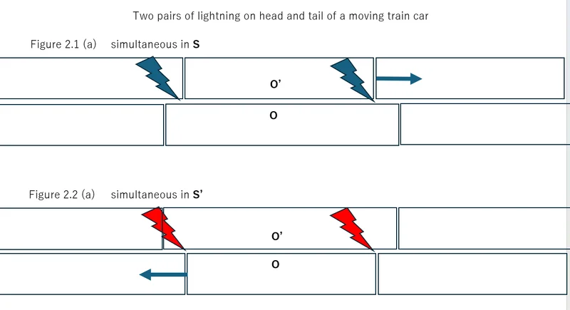

The author explains the figures saying "the point of view of S(or S′)". Therefore, there is a possibility that readers may misunderstand these figures as referring to the same event. A pair of lightnings which are simultateous in S and not so in S' and another pair of lightnings which are simultateous in S' and not so in S are different events. Same naming of contact points, i.e., A-A' and B-B' for O-O' helps misunderstanding.

In both scenarios there are two events. Just because the two events are simultaneous in one of the frames doesn't make them the same event. They would also have to occur in the same place for that to be true.
