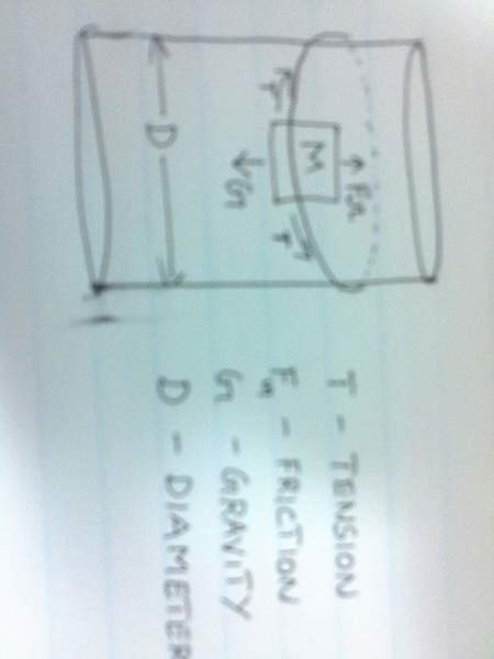

please see attached drawing. I am trying to understand how this would work.
Imagine a vertical cylinder of diameter "D". I would like to tie a mass M to it, using a rope. what is the tension "T" that is required on the rope?
I assume the force required will depend on the coefficient of friction between the cylinder and the mass, let us assume that to be "mu".
but in this case, friction force = mu * force perpendicular to the cylinder surface
how to calculate this perpendicular force? is it just equal to the tension T? I am confused because when a rope goes though a pully we always assume tension to be tangential to the pully at any given point...
any clarifications of my understanding is welcome!

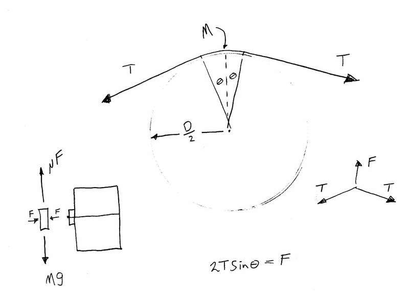

I have redrawn the problem a bit, I think the physics remains the same. Hope this helps.
You wrote,
No in general. I think you would have to accurate dimensions of the mass M to calculate what fraction of T presses mass M against the cylinder. My sketch above takes liberty with the dimensions as none were given.
That clarified my doubt..thanks.
