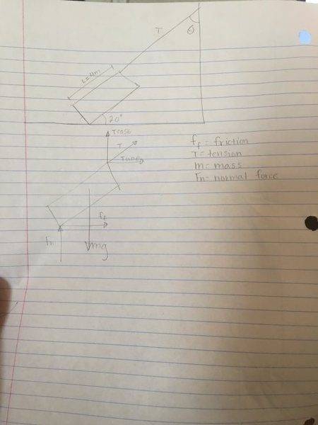

A uniform cylinder with mass 100kg, length 4.0m, and radius 12cm is supported by a rope as shown. The coefficient of static friction between the cylinder and the horizontal is 0.60. The cylinder is just about to slip to the right. What is the tension in the support rope and the angle the rope makes with the vertical wall?
Sum of forces
Sum of torques
Will post below.
I'm getting that the tension is equal to (mass x gravity) / 2
I did not get the same result as you did. But I have to say that I don't have a lot of confidence in my result. It would help if you could show your work.
Edit: I guess I didn't answer your question in the title of the post. The FBD looks right, although I probably would have drawn the friction force facing the opposite direction.
Vitani11 said:
A uniform cylinder with mass 100kg, length 4.0m, and radius 12cm is supported by a rope as shown. The coefficient of static friction between the cylinder and the horizontal is 0.60. The cylinder is just about to slip to the right. What is the tension in the support rope and the angle the rope makes with the vertical wall?...
Are you sure of direction of frictional force ?
That's how the problem was stated. I didn't think it would be physically possible to slip right either, if that's what you're saying.
Note that the tension force has a horizontal component to the right. What keeps the cylinder from sliding to the right?
Buffu is asking you to think about the direction of the friction force acting on the cylinder.
