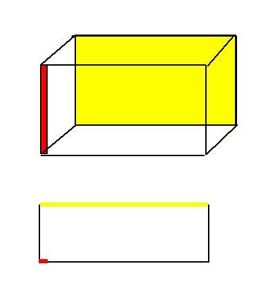

If the resistivity rho and the dimensions are known, any schoolboy can calculate the end-to-end resistance of a strip of metal. But how do you do it if the strip is not regular as in the image?

Shawl, it's macroscopic bur forget this example.
Could you consider a diamond shaped object connected to a + and a - DC at each end and just confirm that there is no easy "1960's university physics level" approach to calculating exact end-to-end resistance.

Not sure where 1960 came from, people were plenty bright in that year! If your question is whether the calculation is non-trivial, then the answer is yes, non-trivial. You can analyze it exactly using conformal mapping, finding the potential and current stream lines in terms of Jacobi elliptic functions. The expression for resistance is then fairly simple, but it does depend on the form of the contact at each end (injecting current at an idealized point located at the diamond's corner creates mathematical difficulty with infinite current density, etc.) Find this in Lawden, Elliptic Functions and Applications. The resistance of flat plates of various irregular shapes can also be calculated approximately using an energy variational approach, as shown by Hammond in Energy Methods in Electromagnetism. I'm sure there are many other references (and approaches). I think none will be trivial.

Could you have a look at this figure where the heat (or current) enters along a short length on one side and flows to an equal temp (or potential) on the opposite side.
What approach should be used to resolving this case?

The fastest and most practical approach is not analytic at all. Use a finite-element code to solve it. There are many for E&M and for thermal simulations, and at least one (EMAS) that does both in the same package at the same time.
