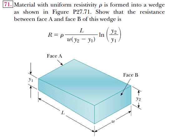

It is the same situation with this other problem from Serway 6E. The result is obtained considering the wedge as a superposition of serial resistors slices and doing an integration over L dimension (in each slice the current is constant):
svg.image
But it is not possible to arrive at the same result considering the wedge as a collection of parallel resistors strips in w direction because the current is not constant inside one strip. The initial height of one strip is Y1 and the final height is Y2 and then the current is not constant on each strip.

That really is not the same assumption. The Serway problem states that the current is the same for every slice. Furthermore, the "resistors" are in series, not in parallel.
It does appear that Serway has a typo in that integrand.
The integrand should be ##\displaystyle \ \frac 1 {\ y_1 ~ w + \left(\frac{y_2-y_1}{L}x \right) w \ } ## .
Ha,ha.. the typo in the integrand is mine, not from Serway.
And of course, the resistors are in serial (not in parallel). That's what I said...
Instead of this, if we try to do the integration considering parallel strips from face A to face B, it is not possible to do the integration because the current is not constant over one of each strip.
I think this is the reason but I'm nor sure. And don't know if there is another kind of assumption we could make to arrive at the same results but considering parallel strips.
In the original problem of the half ring, it happens the contrary, the integration is made considering parallel strips and we cannot make the integration if we choose serial slices.
