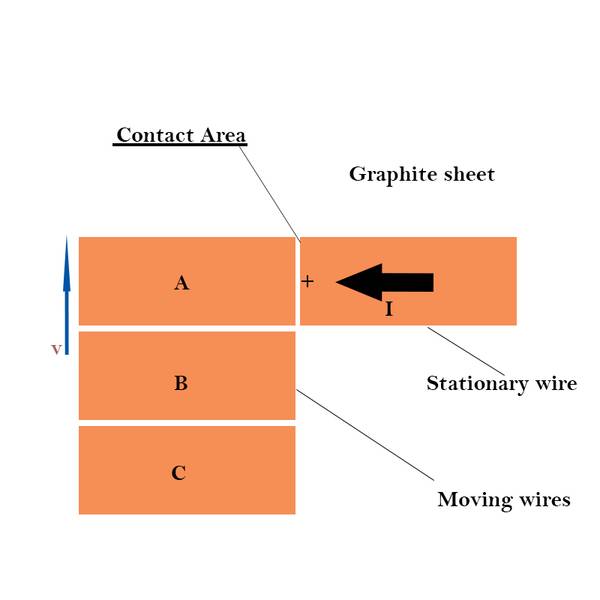

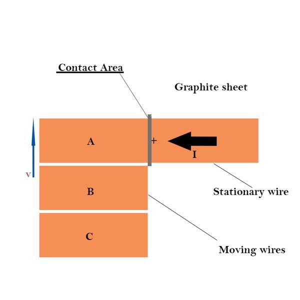

To explain the set-up simply, there is a copper bar that must transfer current to a moving array of copper bars of equal contact area, similar to a motor's set-up of having a brush connected to the commutator. A diagram:
Diagram of a stationary graphite sheet in contact with three moving copper bars labelled A, B and C stacked vertically; a blue arrow marked v shows their motion, a black arrow marked I shows current flow in the sheet, and a contact area is marked at the junction.
Where the contact area is empty, and I cannot directly connect the two copper surfaces to avoid welding, and further damages due to the high velocity of the bars. Therefore, the use of thin graphite sheet with low resistivity would help in avoiding various problems related with motion and the friction generated from it(mechanical and electrical problems):

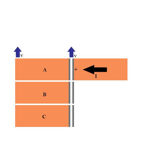

Diagram of a stationary graphite sheet in contact with three stacked moving copper bars labelled A, B and C, with a moving arrow labelled v, a contact area and current I.
The moving array of copper bars(A to B to C) are moving rapidly, therefore, to avoid wearing and any possible "break" of the circuit, having a graphite sheet in-front of each bar's surface(A,B,C) is a solution?
Predicting the wear is important, so I'd know when the replacement is required so that current flow is constant throughout the change of bars A, to B , to C.
I calculated the resistivity, it is higher than the circuit's load, therefore, adjusted the dimensions of the sheets thinner(reducing L) and increasing the area with respect to the bar's area resulted a lower resistance.
If the contact is sliding then any cloth in the gap will be rapidly destroyed and short circuit everything nearby.
What happens while two of the moving conductors are shorted by the fixed bar ?
I really do not have your confidence that graphite cloth is a solution. It needs some bonded graphite block.

The contact is of sliding motion between the fixed bar and the array of bars A through C. At what rate is the cloth rapidly destroyed? How can I start to calculate(or estimate it)? If the cloth(being extremely thin) can withstand the complete motion(or passing) of bar A at full conductivity then I could place a cloth for each bar(A - C) and for the fixed bar per each bar like so:
Schematic of three stacked orange bars labelled A, B and C, with a grey fixed bar at their right ends; a blue arrow labelled v points upward on each, and a black arrow labelled I points left at the top of the fixed bar.

No. I mean as the fixed bar is half way between A and B it is shorting A and B to each other.
Baluncore said:
What is the voltage between adjacent moving conductors?
PhiowPhi said:
V = 3.67 x 10 ^-5
That is only 36.7 microvolts. Is that the voltage drop across the sliding contact, or the voltage between A and B and between B and C.
You need to draw a circuit that shows what everything is connected to, and the full path taken by all currents.
