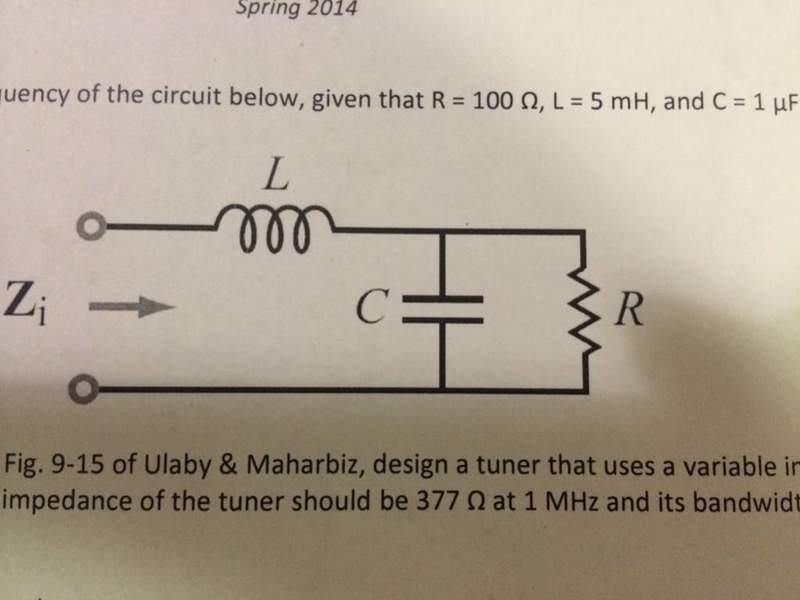

Hello, I am working on this circuit to find the resonant frequency.

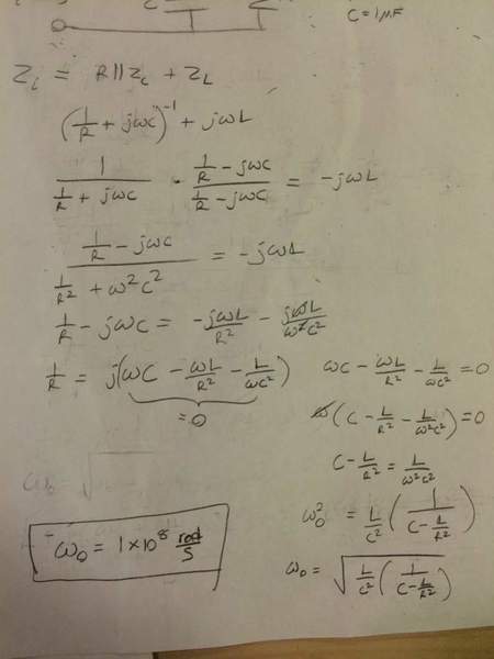

I calculate 10^8 rad/s, but the solution says it's 10^4 rad/s. Here is my work. I just solved for the equivalent impedance, and then separated the j term and solved for the inside of the parenthesis to be equal to zero.
Am I wrong or the solution?
Thank you
Hey, you should make imaginary part of impedance zero not the whole equation because at resonance the circuit will be purely resistive ...impedance doesnot equal zero
Likes 1 person
Thank you very much, I solved it now!
