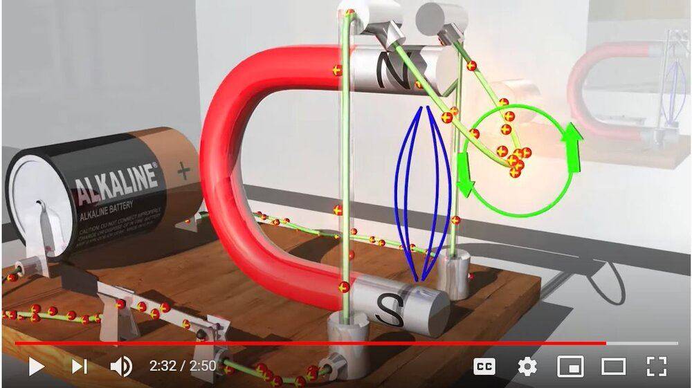

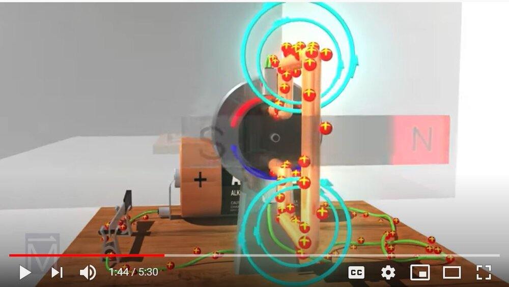

What? Lorentz force can really react at 1/60 sec given typical current? Hmm... do you (or anyone) know where I can get the following? Before going further with motor. I have to play with lorentz force first to get a feel of the force of it.
  • #37
Why wouldn’t it? What exact frequency would stop it and what physically would happen at that frequency to stop it?

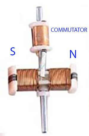

I saw this with the north pole at right side and south pole at left side of the inductor
In the case of this actual part in the amazon motor high school kit, where is the lines of force? the top copper is just the commutator, the bottom two cooper is the windings
