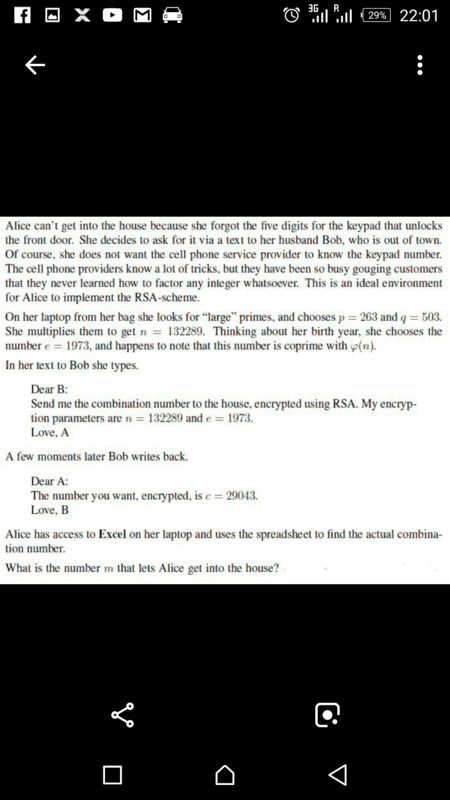

I am learning... I don't know everything. Actually find attached the problem that I was attempting to solve using the.. modular multiplicative inverse.

The basic idea is, that we can calculate with the remainders of a certain division. E.g. a division by ##5## has the possible remainders ##0,1,2,3,4##. All of them can be added and multiplied, such that we get again a remainder of division by ##5##. Say ##2 \cdot 3 = 6## which has the remainder ##1##. Thus ##2\cdot 3 \equiv 1 \mod 5##. And if you check then you will see that all integers with remainder ##2## multiplied by any integer with remainder ##3## always results in an integer with remainder ##1##. The same is true for addition.
This immediately raises the question, whether subtraction and division is also possible. Subtraction is no problem. Multiplication is a bit more complicated. In case of the module ##5## as above, all elements ##1,2,3,4## (of course not ##0##) can be inverted, hence we can divide with them. E.g. we have already seen that ##2\cdot 3 = 1##, which means ##2^{-1}= 3## and ##3^{-1}=2##. The reason that it works is, because ##5## is a prime and all integers other than zero are coprime to ##5##.
If we had for example division by ##6##, a module ##6## or ##6\mathbb{Z}## to be precise, we get ##2\cdot 3 =6 \equiv 0 \mod 6## and we cannot divide neither with ##2## nor with ##3##. They do not have inverses. Coprime remainders as ##1## and ##5## have inverses, ##2,3,4## do not.
You see, the situation changes if we change the module. The Euclidean algorithm you performed above can be used to find an inverse, the way you did it.
Yeah. that's the key idea in RSA. It requires Euler Totient Function. The book by Pommersheim has an explanation of different types of encryption and why RSA is better than the previous encryption shown in the text. Yes, multiplicative inverse is important. I suggest buying the book, before trying to solve anything more. It would make way better use of your time, and you gain more. Then, if you have studied a bit more of analysis, you can move onto Apostol: Analytical Number Theory.
Thanks, i think with the attachment on the rsa problem, you can now understand why i was looking for the multiplicative inverse...my area of speciality was in applied maths, i will nevertheless take Midget's advice to do more reading on number theory. regards,
