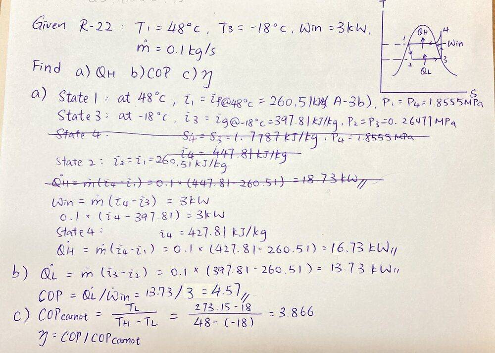

A vapor compression refrigeration cycle uses R-22 and follows the theoretical single-stage cycle. The condensing temperature is 48 oC, and the evaporating temperature is -18 oC. The power input to the cycle is 3 kW, and the mass flow rate of refrigerant is 0.1 kg/s. Determine (a) the heat rejected from the condenser, (b) the coefficient of performance, and (c) the refrigerating efficiency.
R-22 table
Refrigeration system
Can efficiency be larger than 100%?
I have double checked the values of
enthalpy of point 1,2,3 from R-22 tables.
And I obtained enthalpy of point 4 from the work done given.
Thank you.
I can't read your handwriting. What do the i's stand for?
From your tables, what are the conditions at 1,2,3, and 4 ? (T, P, u, h, s)
i is enthalpy, same as h as your notation.
(From R22 table)
i1=i2=260.51
i3=397.81
W=m(i4-i3)=3kW
i4=427.81
Ql=m(i3-i2)=13.72
COP= Ql/W=13.72/3=4.57
=>Which is higher than COP(theoretical)= 3.866
Is there anything I have done wrong?
Thank you.

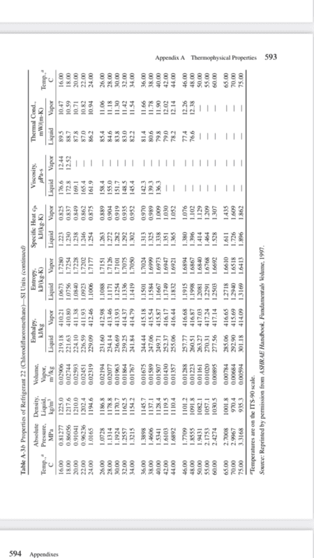

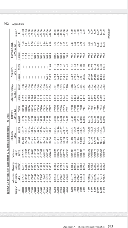

I'm having trouble comparing with you because my tables must be different from yours. At point 3, my tables show a specific enthalpy of 242.92 kJ/kg, and at point 1, they show a specific enthalpy of about 106 kJ/kg. So, we show the same difference between these two states. But, it's hard for me to help without the same exact tables as yours.
My tables are attached here
That 30 kJ/kg seems very suspicious. What would the work have been if the compression were isentropic and the pressure of the superheated vapor exiting the compressor were the equilibrium vapor pressure at 48 C?

For isentropic operation of the compressor with an exit pressure of about 19 bars (the pressure in the condenser), I estimate an enthalpy change of about 50 kJ/kg (for the ideal compressional work). That should really be the minimum amount of work.
The problem is invalid, right?
It seems that way to me. Maybe the 3 Kw is a typo, and it should have been 5 Kw. How would that affect your answer and your conclusions?
