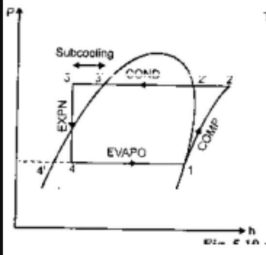

Please find below a schematic diagram if it is of any help.
The heat exchangers have plates and are using water and refrigerant.
  • Hand-drawn lg P versus h diagram of a vapor-compression refrigeration cycle with points 1, 2, 3, 3', 4, 1' and labels for condenser, compressor, expansion valve and evaporator, beside a list of operating values.

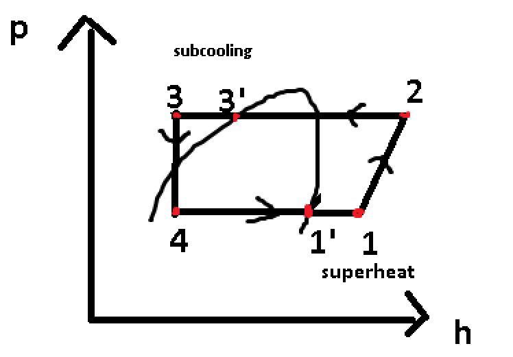

If I'm asked to plot a log p-h diagram for the following statement:
"A building needs a thermal power for heating Q = 12 [kW] at with a condensing temperature tc = 44.3 deg C, the heating being performed with heat pump. The heat source is represented by the soil. The installation works with a refrigerant whose vaporization temperature is tvap = -7 deg C. The degree of subcooling of the installation ΔtSC = 5 deg C."
So for this case on the log p-h diagram I should plot just the sub-cooling part, right? I wasn't told anything about superheating.
The question is...can we have sub-cooling without super-heating though?
So should I plot just the sub-cooling process on the log p-h diagram? Or should I plot both sub-cooling and superheating on the log p-h diagram?

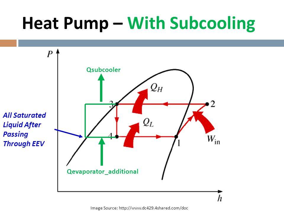

Should the log p-h diagram be like Fig.1 or like Fig.2? (please see below)
  • Log p-h diagram of a vapour-compression refrigeration cycle with pressure on the vertical axis and enthalpy h on the horizontal axis, showing points 1, 2, 3, 4 with labels for subcooling, condensation, compression, expansion and evaporation, caption Fig. 5.10.
  • Generic p-h diagram of a vapour compression refrigeration cycle, pressure p on the vertical axis and enthalpy h on the horizontal axis, with a saturation dome and points 1 to 4 joined by lines.
Hi, thanks for the quick reply, I do appreciate it.
The problem is that I have to plot the p-h diagram for the heat pump myself, but not sure if I should have just the subcooling process since I was given just the subcooling degree "It is known that the degree of subcooling of the heat pump ΔtSC = 5 deg C."
Or should I have both sub-cooling and super-heating, though the word superheating was not specified within the text...that got me confused, is it possible to have just subcooling without superheating for the heat pump?
"A building needs a thermal power for heating Q = 12 [kW] at with a condensing temperature tc = 44.3 deg C, the heating being performed with heat pump. The heat source is represented by the soil. The installation works with a refrigerant whose vaporization temperature is tvap = -7 deg C. The degree of subcooling of the heat pump is known such as ΔtSC = 5 deg C."
Don't know if to plot the p-h diagram just with the sub-cooling or with both sub-cooling and superheating, based on the text provided above.

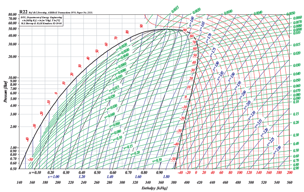

Anyway, for the coolant (R22) I assume the log p-h diagram is something like this:
Log pressure-enthalpy diagram for R22 refrigerant with saturation dome, isotherms in red, isentropes in blue, isochores and quality lines in green; pressure in Bar, enthalpy in kJ/kg, labelled Ref R.Downing ASHRAE 1974.
I found a P-H diagram. In my judgment, the correct diagram should be Fig 1. Although they don't say there is superheating, its seems obvious that the vapor exiting the compressor should be superheated at 17 bars. Just follow an isentrop upward from a saturated vapor at 4 bars.

Right, okay. So, now with the actual given data if I'm asked to plot a log p-h diagram for the entire heat pump, it should resemble the one like in Fig.1, right? Just the subcooling part basically, because superheating (before entering the compressor 1-1') was not stated anywhere within the text. When I am speaking about superheating I am referring to the one before entering the compressor. I currently don't know based on the provided data if the p-h diagram should include the superheated process right before entering the compressor, given that the input data (text) hasn't specified anything about superheating.
So how should the log p-h diagram look like for the heat pump?

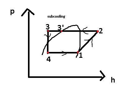

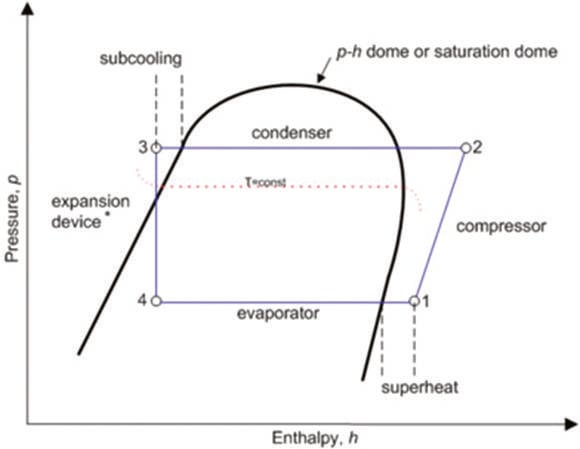

I would assume it is saturated vapor before entering the compressor. It exits the compressor as a superheated vapor at 17 bars and on the order of 70 C. This is consistent with your Fig.1. So it enters the condenser as a superheated vapor and exits as a sub cooled liquid.
Hi
Thanks for your reply.
Like I should not have superheated process 1-1' before entering the compressor.
I am trying to understand why I was not given any information on purpose regarding the superheated process before entering the compressor.
So, the p-g diagram, should look something like this, right? (please see below)
  • P-h diagram of a heat pump cycle with subcooling: a saturation dome with points 1, 2, 3 and 4, red arrows for QH, QL and Win, and green boxes marking Qsubcooler and Qevaporator_additional, with a note that the liquid is all saturated after the EEV.
  • Pressure-enthalpy (P-h) diagram of a vapour-compression refrigeration cycle with labelled points 1, 2, 3, 4 and 4', showing subcooling, COND, EXPN, EVAPO and COMP process lines under a saturation dome.
Martin Harris said:
Hi
I don't know what 1-1' means. But, in any case, Fig. 4, not Fig. 3

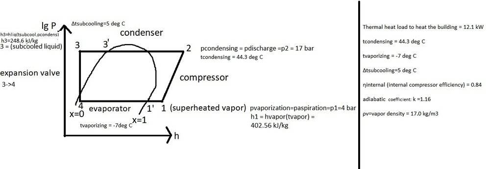

Hi,
Thanks for the reply.
Please see Fig.5 and Fig.6 below, where 1->2 compressor, 2->3 condenser, 3->4 expansion valve, 4->1 evaporator.
Which one would you say that is now the correct p-h diagram for the above given data for the heat pump?
  • Hand-drawn p-h diagram of a heat pump cycle with pressure p on the vertical axis and enthalpy h on the horizontal axis, showing points 1, 2, 3, 3', and 4 with a 'subcooling' label near the top.
  • Hand-drawn p-h diagram of a vapour-compression refrigeration cycle with points 1, 1', 2, 3, 3', and 4 labelled, with subcooling and superheat marked and a saturation dome.
Martin Harris said:
Hi,
Figure 5
