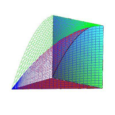

The first step in solving a problem like this is to draw a picture of the 3d figure. Have you done that? You need it to see the proper limits.
The reason x first is tricky is that when you go from x on the back, which is x = 0, to x on the front, the front surface is in two pieces, partially a plane and partially a curved surface. You will need two integrals.
Yes I have drawn it. I am having trouble figuring out how to split it up. Could I by chance get a hint on how to split it up? Thank you.
For #4, try sketching on the xy plane the intersection of the solid and a plane of constant z. It may be easier to ignore the constraint on y initially and then add it back in later.
Similarly, for #5, sketch on the xz plane the intersection of the solid and a plane of constant y. Again, it may be easier initially to ignore the constraint on x and then add it back in later.
I have posted an image to help you see this.
3D plot of a solid bounded by curved surfaces meeting at a shared edge, drawn as a mesh with a red wall and a black curve on the cylindrical surface.
This image shows the projection of the intersection of the two surfaces onto the yz plane. The equation of the cylindrical "wall" (shown in red) that projects onto the yz plane is gotten by setting the x values of the intersecting surfaces equal to each other. The black curve in the zy plane is where the wall intersects the plane and gives you the limits on the two zy integrals that have different "front" surfaces.
[Edit]Fixed x and y were reversed.
