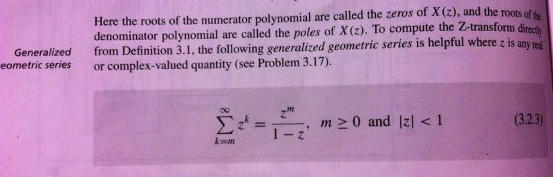

The formula for the geometric series that I have is
[itex]\sum z^{k}[/itex]=[itex]\frac{z^{m}}{1-z}[/itex],m≥0 and lzl<1
My m in this case would equal 0 because my limits are 0-21. so the z in the numerator becomes 1 and the z in the denominator is my z which equals (0.6/z). This was my reasoning anyway. Do I just need to have notation instructing to stop the sum at 21?

Here's the formula I mean:
http://en.wikipedia.org/wiki/Geometric_series#Formula
I got that formula from my DSP book. Ill take a look at the one you have posted from wikipedia and see if i can understand how to apply it.

Ok so I looked back and I am unsure if I am using the geometric series correctly.
This is what I have for a definition in my book.
Printed textbook page showing the generalized geometric series formula: the sum from k=m to infinity of z^k equals z^m over (1 - z), for m greater than or equal to 0 and |z| < 1, labelled equation 3.2.3.

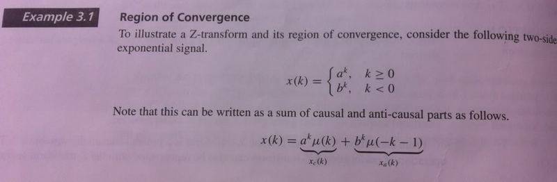

This looks ok to me i think. Especially since there is an example that is very similar in my book that I followed. The only problem is I don't have the limit of 21 defined anywhere. The example in the book is 0->∞ My problem above is 0->21... Where does this upper limit of 21 come into play?

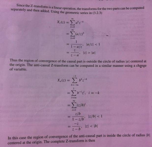

Here is the example for your reference.
Textbook page, Example 3.1 Region of Convergence: piecewise signal x(k) = a^k for k >= 0 and b^k for k < 0, and its causal/anti-causal sum a^k u(k) + b^k u(-k-1).
Printed textbook page deriving the Z-transform of causal and anti-causal sequences using the geometric series, with equations for Xc(z) and Xa(z) and their regions of convergence.
The X[itex]_{c}[/itex](z) in this example is what I believe to be very similar to my problem above.
