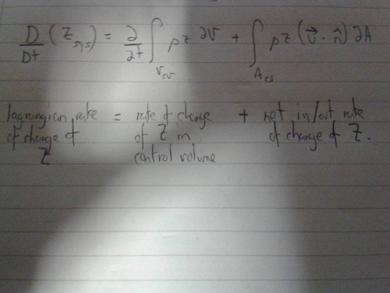

hello all,
I just wanted to check my worded interpretation of this otherwise messy result is ok:
Handwritten Reynolds transport theorem: D/Dt(Z_sys) = d/dt integral over V_cv of rho z dV + integral over A_cs of rho z (v . n) dA. Below, the words: Lagrangian rate of change of Z = rate of change of Z in control volume + net in/out rate of change of Z.
it is the reynolds transport theorem just in case i didnt mention :)

Please check your notes. This is not a correct rendering of Reynolds Theorem.

is the formula correct? is it my interpretation that needs revising?

The formula is incorrect.
