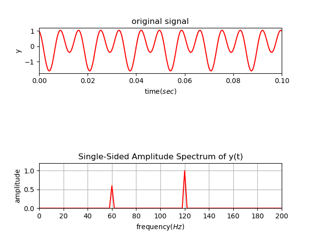

If a pulse is sinusoidal wave form, the problem becomes quite simple. I can find exact frequency because Fourier transform of sinusoidal wave form has finite number of frequency.
Two plots: top, a sinusoidal-looking signal against time with peaks of equal height; bottom, a spectrum of peaks against frequency with a tall central peak and smaller peaks on either side.

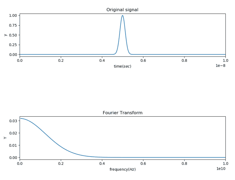

But Fourier transform of Gaussian is Gaussian which has infinite number of frequency. That means each wave of frequency has different power. Is this right?

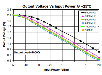

Line graph titled Output Voltage vs Input Power (A ratio), with output voltage on the vertical axis and input power in dBm on the horizontal axis, showing several downward-sloping curves for different detector models.
I can't come up with which value is output from power detector. I am confused that the output of power detector is just one value or a continuous liner value.

  • Two-panel plot: top, red time-domain signal y against time (0 to 0.1 s) showing a periodic waveform with amplitude about 1 to -1.5; bottom, single-sided amplitude spectrum with peaks near 60 Hz (about 0.6) and 120 Hz (about 1.0) on a 0 to 200 Hz axis.
  • Two stacked plots: top, a Gaussian-shaped pulse in time (sec, 1e-8 scale) peaking near 0.5 at about 0.5e-8 s; bottom, its Fourier transform, a Gaussian-shaped curve in frequency (Hz, 1e10 scale) decaying from about 0.032 near 0 Hz to near zero by about 0.4e10 Hz.
  • Line graph titled Output Voltage Vs Input Power @ +25°C: output voltage in V (0.5 to 2.3) against input power in dBm (-50 to 20) for six frequencies from 10MHz to 8000MHz, with output load 1000Ω; the 8000MHz curve falls most steeply.

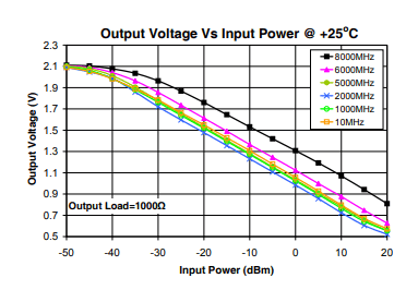

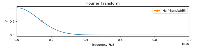

I have a Gaussian like shaped pulse waveform. It has 0.3ns pulse width, and it means 1.45Ghz half-band width in my calculation. If signal has 13dBm then what is output voltage from power detector? Is this enough information to calculate output or not? It's ok if I could get approximate value.
Plot titled Fourier Transform of a low-pass shaped curve, Y from 0 to 1.0 against frequency in Hz from 0 to 1e10, falling from 1.0 near zero frequency to near 0 by about 0.4e10, with an orange half-bandwidth marker at Y = 0.5 near 0.15e10 Hz.
Line graph titled Output Voltage Vs Input Power @ +25°C, plotting output voltage in V (0.5 to 2.3) against input power in dBm (-50 to 20) for six frequencies from 10MHz to 8000MHz, with output load 1000Ω; all curves fall roughly linearly, with the 8000MHz curve lying highest.

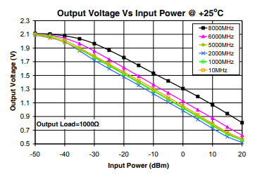

  • Line graph titled Output Voltage Vs Input Power @ +25°C, plotting output voltage in V (0.3 to 2.3) against input power in dBm (-50 to 20) for six frequencies from 10MHz to 8000MHz, with output load 1000Ω noted; all curves fall as input power rises, with the 8000MHz curve lying highest.
  • Plot titled Fourier Transform of a low-pass shaped curve, Y from 0 to 1.0 against frequency in Hz from 0 to 1e10, falling from 1.0 near zero frequency to near 0 by about 0.4e10, with an orange half-bandwidth marker at Y = 0.5 near 0.15e10 Hz.
  • Line graph titled Output Voltage Vs Input Power @ +25°C, plotting output voltage in V (0.5 to 2.3) against input power in dBm (-50 to 20) for six frequencies from 10MHz to 8000MHz, with output load 1000Ω; all curves fall roughly linearly, with the 8000MHz curve lying highest.
I don't like the fact that you have a DC offset on the power meter calibration. Best to re-draw the graph with 2.1 volts as the zero and reading upwards.
If 13dBm is the average power, then a power meter with an averaging CR circuit (or just a slow analogue meter) would read around 0.9 volt depending on carrier frequency.
If 13dBm is the peak power, then a power meter fitted with a peak reading capacitor will similarly read 0.9V. In this case I don't know what average reading you will get.
